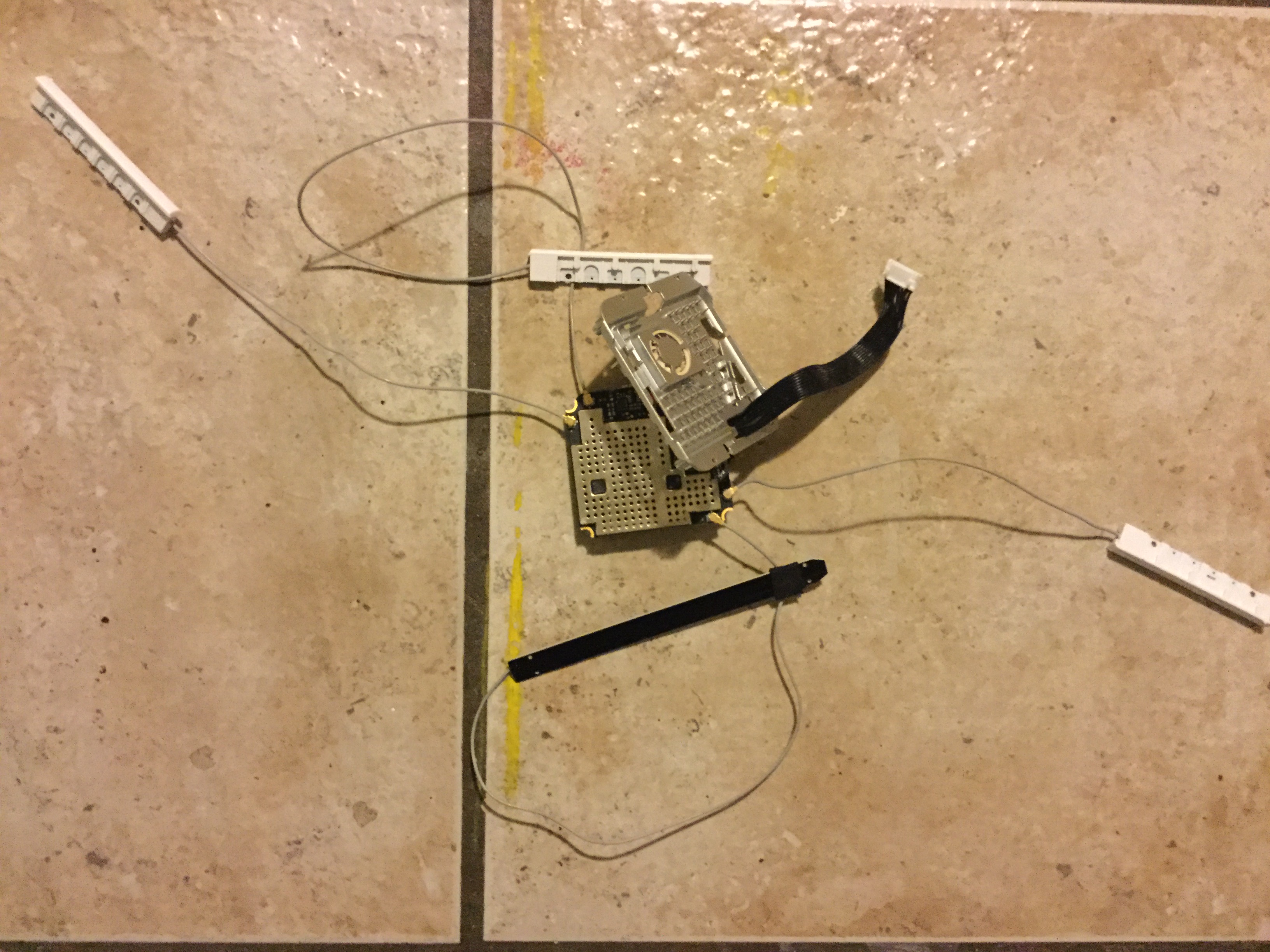

I can not separate this antenna just cut it off and solder the RC antennas.

Thanks, I currently have a setup like this
And want to make it a little cleaner should be able to just connect the 2.4ghz phantom 3 pro leg antennas.
Do you think it would be possible to replace the inside antennas on the P3S with the in leg antenna for the P3P, i have some extra P3P legs and found the antennas online for $3 my P3S internal antenna has had the connections ripped off.
The P3S uses these...http://www.dronenerds.com/media/pro...-4g-antenna-standard-cp-pt-000284-dji-3f4.png On both the R/C and A/C I do not think... The P3P ones would be of any help at all.. This is what your P3S needs!!! LOL

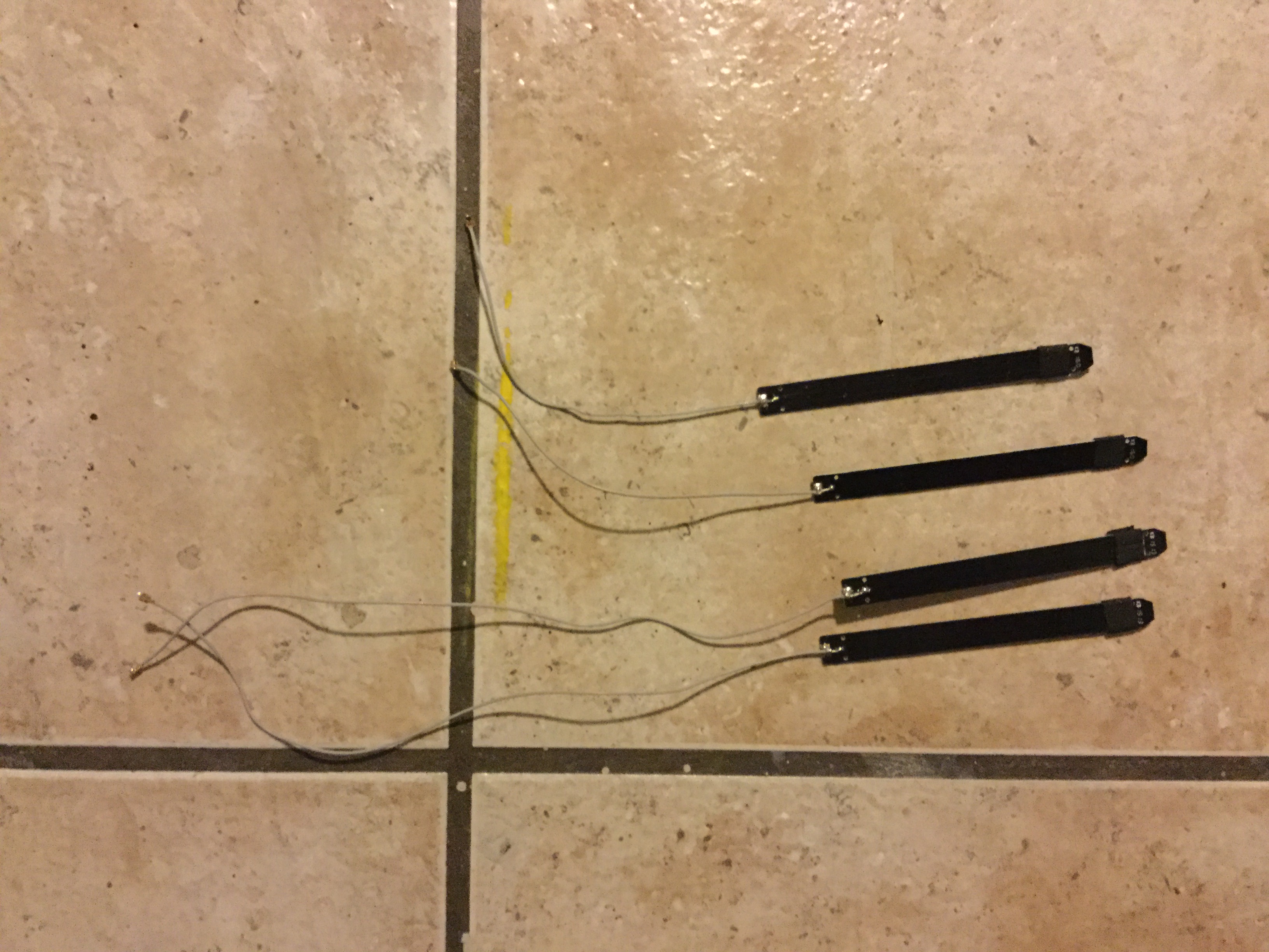

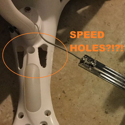

Antenna mods are done!! Take your time it's not that bad.with a little patience getter done.tested it works better than stock dji antenna!!

View attachment 77528 View attachment 77527 Antenna mods are done!! Take your time it's not that bad.with a little patience getter done.
thats looking nice Silverwingflinx .. ive been following this, i think its a good mod and probably get better signal, cheaper. I'm very curious how it works .. i wish there was a quick/easy way to field test the difference, maybe with two phantoms. You've got me wanting to source another set of antennas to try it (i have one extra set right now). My only question is, is that the ones on the bird are numbered .. is that just length of cable, or is there a reason for that numbering .. is there a specific order, etc? They all look exactly the same and antenna principles shouldnt change but curious.
Reactions: Silverwingflinx
Yes they are numbered 2 long Cables go to the front but tricky wiring under light bridge, 2 short the mod went better than I thought easy to do.just keep it in order when u put it back together,but you can always look at your other p3 to get it right.but I don't think it will matter RC and lightbridge probably uses all antennas equally in retrospect(just guessing).and yes I can not do a field test yet that's my old bird the one that the eagle attacked it works for now and nothing blew up video is great.but it is working yea!! thanx Digdat0.

so yes this mod is working,this is good news now I need to fit this antenna mod into my other working flyable P3 that's a 2 hour job yet to be done.wish everyone great success if you try this mod.fly high fly safe.
Reactions: KennethMcNutt
Ok so here is an update! Image transmission signal (i.t.s) on Dji app is higher.channels 1to20 working extremely well,have even more green bars spiking higher on the lower channels then b4,so in conclusion higher DB signal! But yes bench test results the same receiving strong interference from wifi router in my house.sorry guys I had said there was no interference when I first tested!! The I.T.S signal has improved over my stock P3,going by what my HD graphics tell me.
