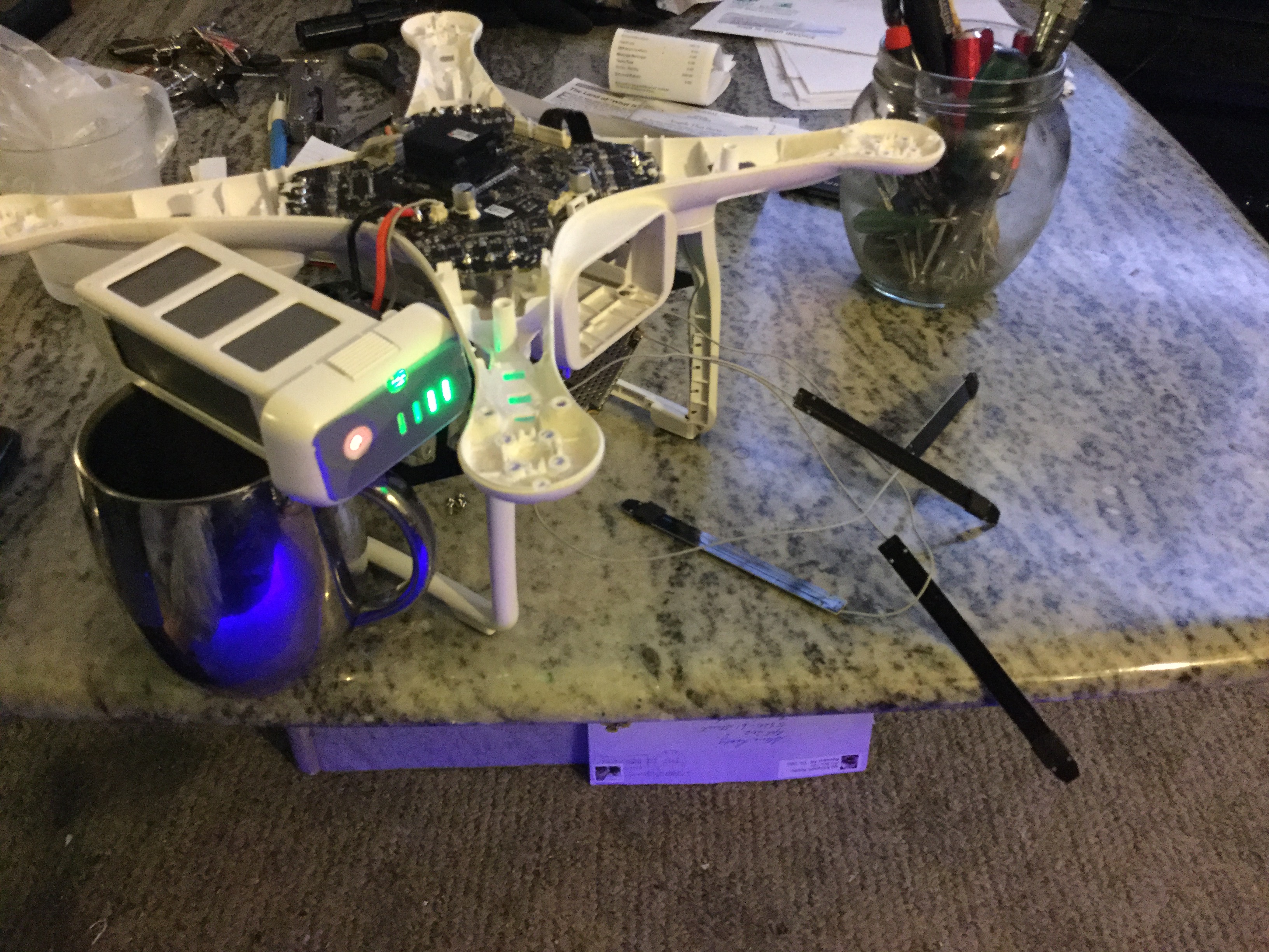

View attachment 77547 Ok so here is an update! Image transmission on Dji app is through the roof,channels 1to20 working extremely well.have even more green bars spiking higher on channels then b4 and the red bars are spiking almost touching the top of bar graph.so in conclusion higher DB signal.also in this same spot sitting on my table,when I would turn on my P3 I would receive weak transmission signal do to my wifi,but now with this mod I have no interference.hhhhhhmmmmm ok! No weak transmission signal.

Hi Kenneth yes not able todo a test flight yet.but exspecting better signal strength.hope your mod goes well.fly high fly safe!
My only concern now is the placement of patch antennas,and direction of the antenna on the bird.the orientation may need to be played with???
Well one more step in the evolution of these antennas seem to be identical haveing the H configuration on one side and long linear line on other side.so mounting and signal streath or orientation,you Will have to mount antennas in the same way Dji has them installed.what I am saying is the H side of antennas 2 facing forward and 2 facing back .i am haveing better confidence in doing this mod! Think I better keep these small white patch antennas.for future mods!
Reactions: Digdat0
My only concern now is the placement of patch antennas ,and direction of the antenna on the bird.the orientation may need to be played with???
I looked into that... It seems I am wrong.... :(
The PCB antennae are not Directional...
They are Omni :)
This seems like it is the OEM Leg antenna...
2X 2.4Ghz 4dbi internal antenna PCB built-in aerial OMNI ipex 47.5*7.2mm NEW | eBay
It is Omni...
and So Is the R/C OEM ones...
They do not have a shield or (panel) to direct the signal
Which would make them Directional...
Soooo... Their placement (orientation) other than vertical should not be of any concern...
