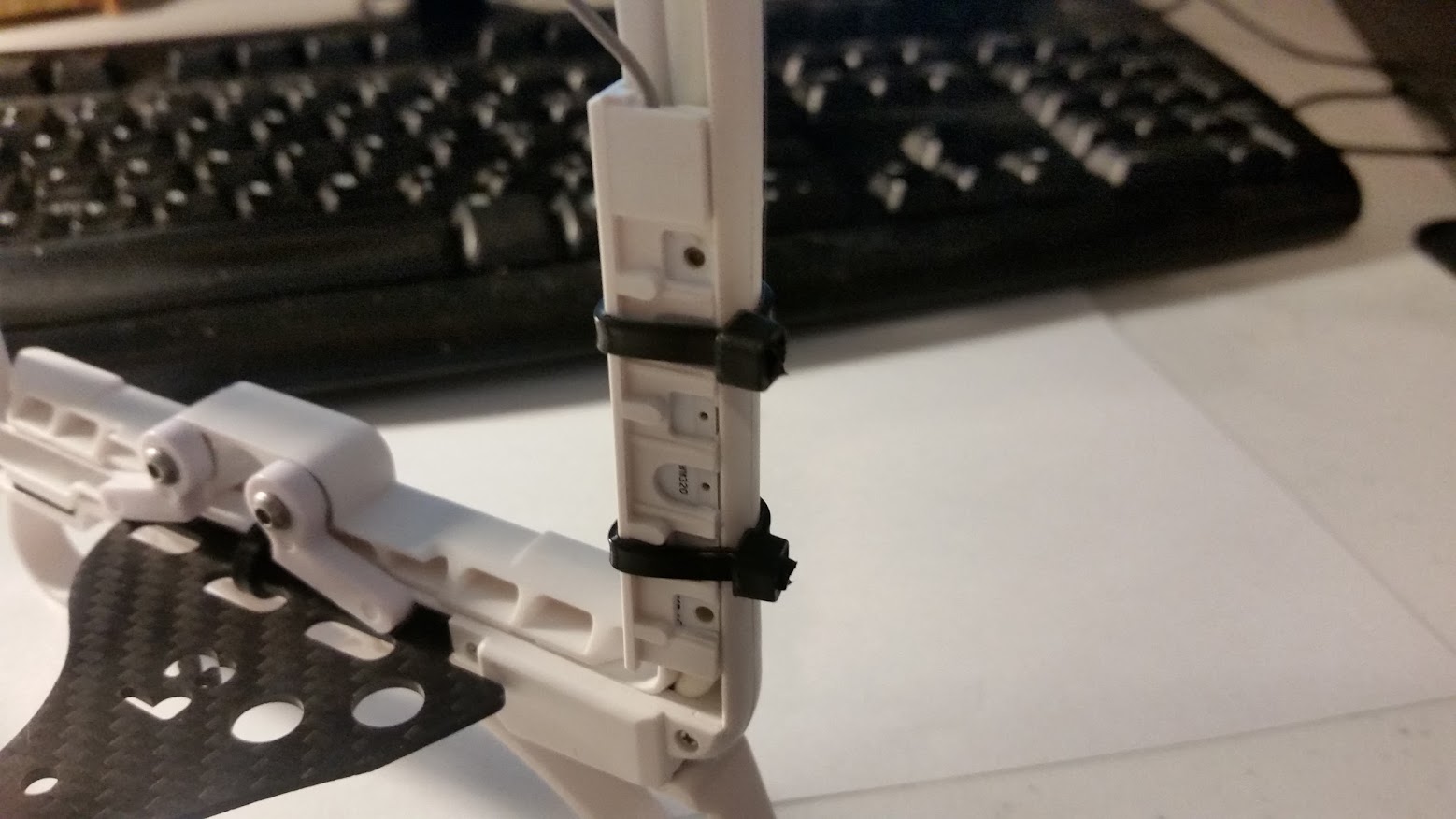

Front/Left

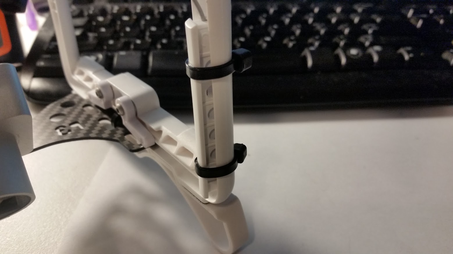

And Right/Rear
Yes, I'll grab some white zip ties, so that it blends in a little more. LOL
Hi, I'm planning on doing this mod. I purchased the antennas, and after zip tying them to the legs according to this pic, I realized they are close to the compass. Could this cause any issues?

Mikosmitho why don't you look for a set of antenna's off of a Phantom 3 4k 2 are 2.4 and 2 are 5.8. just like the Adv and pro looking.
Thanks for the tip on the 4K antennas, I'll look into upgrading the 5.8 later. I'm mainly concerned with attaching the new antennas to the legs and causing any issues with the compass.

I have the same birdside mod as Matts175 on my P3S. My compass mod values stayed the same before the mod. There is no iron/magnetic properties in those antennas.
That's great to hear! I even started my own thread asking about the very same. I was so paranoid about interfering with the compass I taped one of the antennas to the side of the body. Looks like crap, but now I know its not a problem.
Never had any issues and the new owner of my P3S hasn't had any either.
