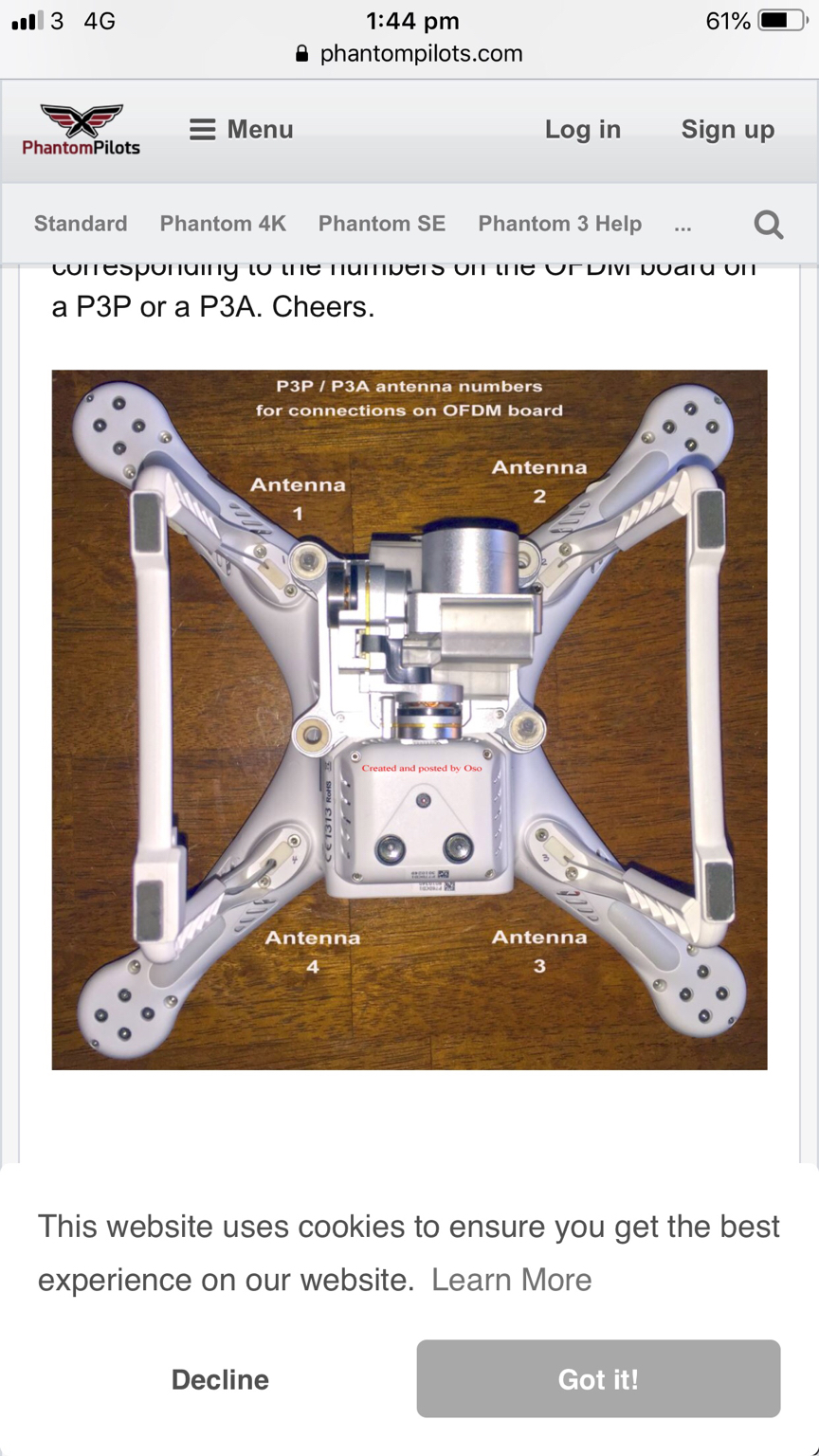

So from this picture what do I connected to each leg and what frequency please
with in my bird
In post 7 you speak about not having to take the lid off but I think you will fine that the connections for the video links of inside of the bird nowhere near the camera
No,..the connections that this thread/mod pertains to are in the gimbal,..read thread from begining and you'll get it,

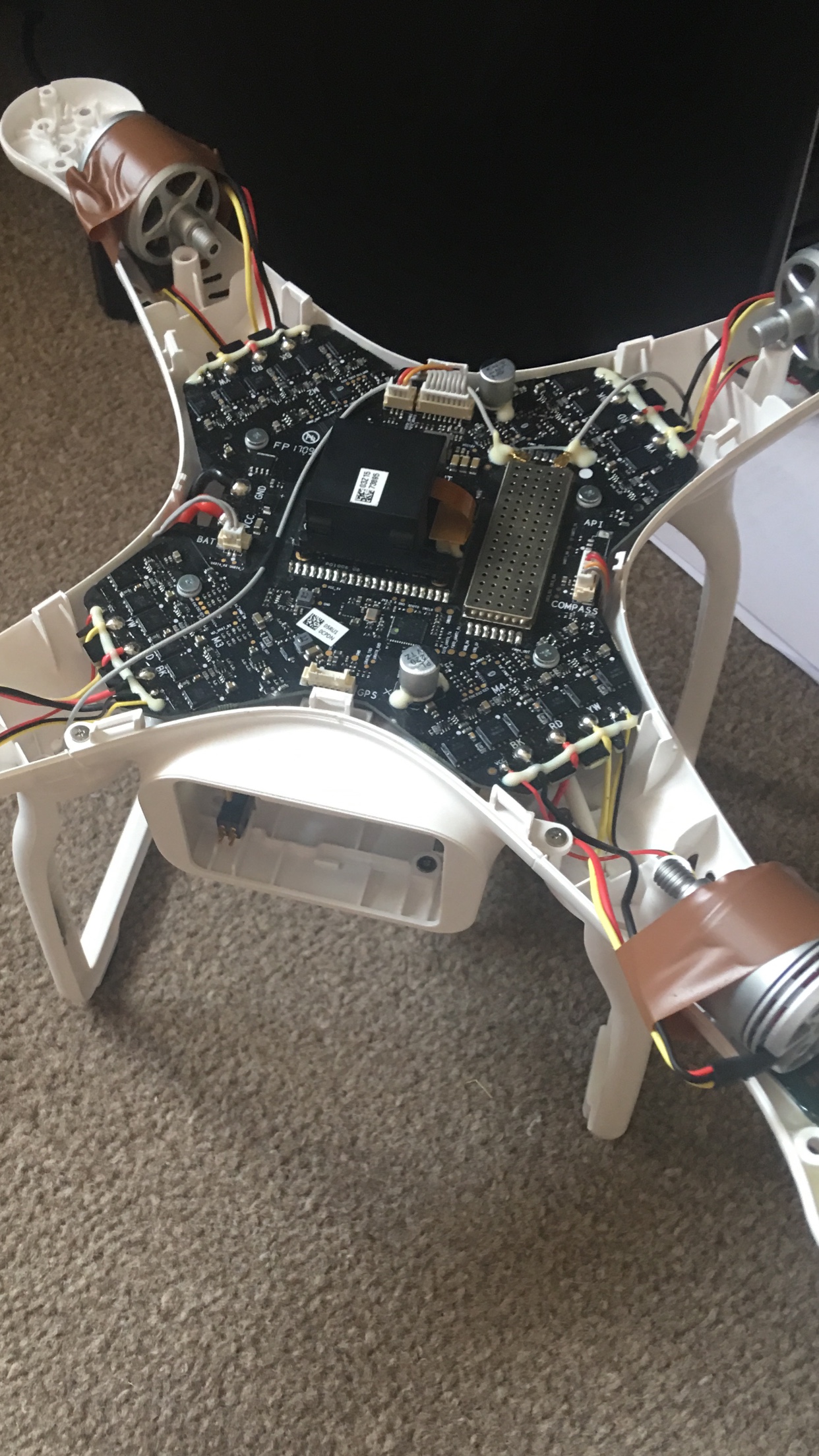

Now from my experience the two gray wires on the legs are for the video down link !
And if you look at the two wires coming from the camera there is one black and one gray so I put it to you why am I changing both the grays wires on the legs I understand that your mod does not involve taking the lid off the bird but I have and again this is what you will see when it’s been opened
Two gray wires coming from a WiFi module that says on the printed circuit board 2.4g now I’m not saying I’m right or wrong but what I am saying is as an electrical engineer I work on two things worst case and fact now this is a little bit out of my depth but I love to tinker it keeps me busy so matt175 take a deep breath and no stressing please enlighten me and the rest of us thank you

Are you sure that your bird is a P3 standard? The one's that have the wires going to inside board are 5.8ghz and are for the control. This mod has nothing to do with that.
