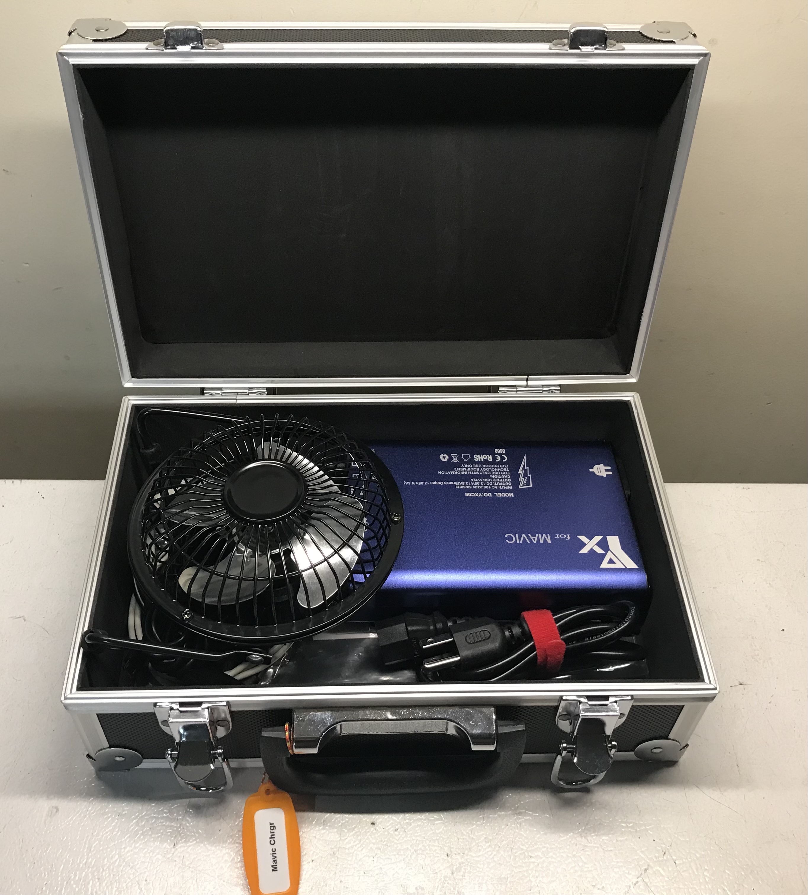

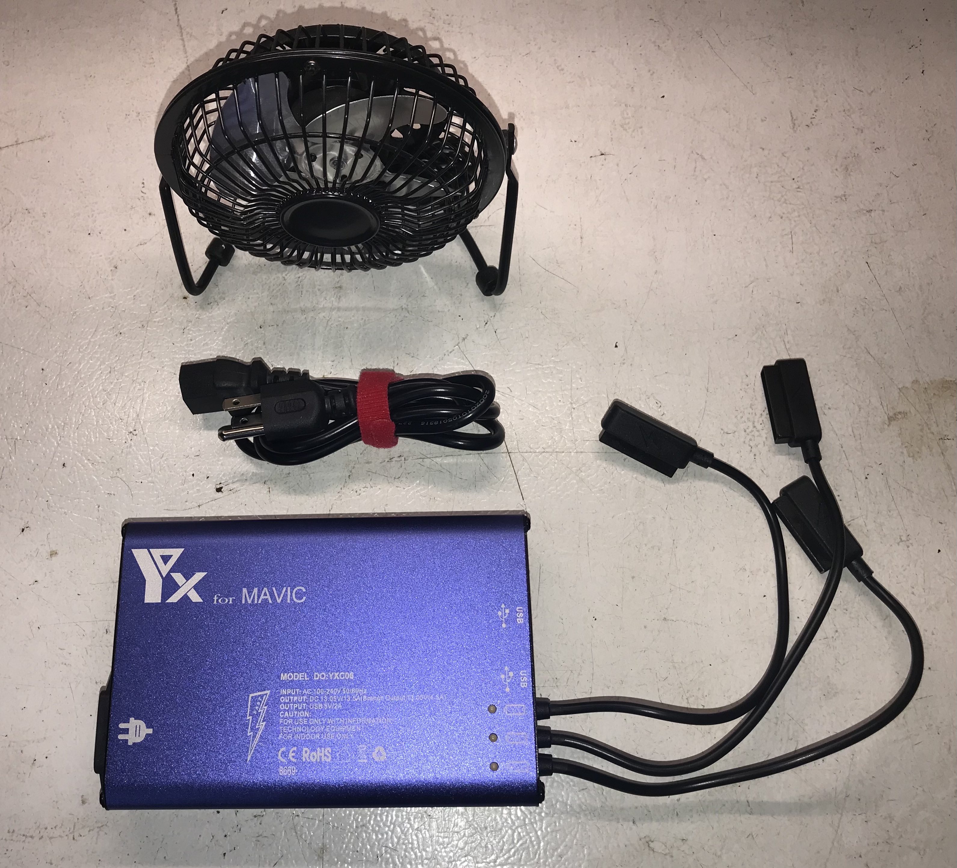

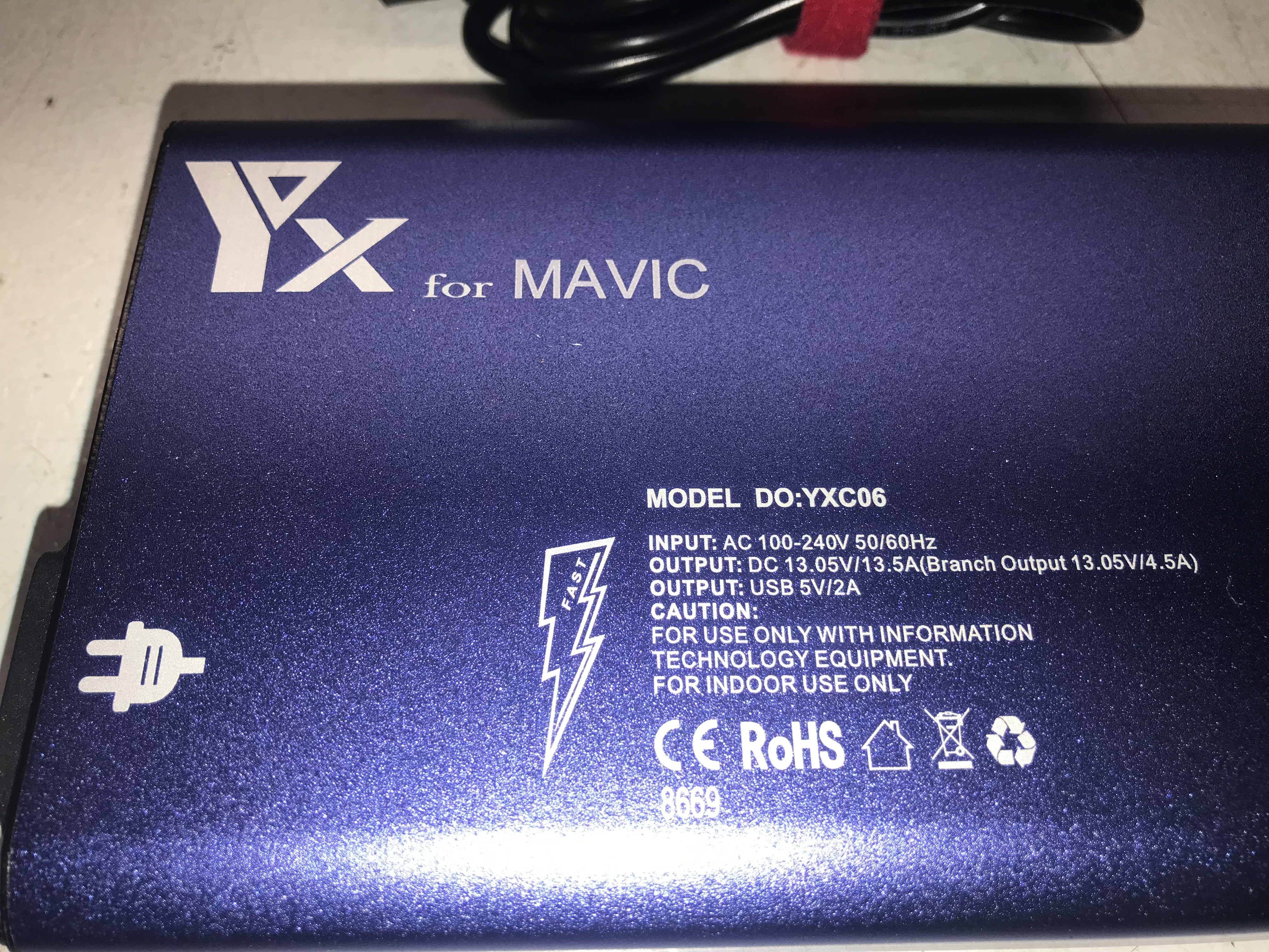

I get involved with search and rescue, media coverage, and UAV flight training where we need to keep a Mavic or Mavics in the air nearly full time for hours at a time landing only to charge the batteries.
For the Mavics, we use AC-powered “Yx for Mavic” smart chargers that are able to charge three batteries at once on separate circuits. We also use USB-powered fans (powered by the Yx) to cool the batteries when needed.
Typically, we need to rotate between 6 to 8 batteries per drone (depending on ambient air temp and wind conditions) to keep the drones flying.
Sometimes events dictate when to swap batteries rather that battery voltage. This is especially true for media coverage.
I would be surprised if Yx or others don’t make a similar charger for the Phantom.
