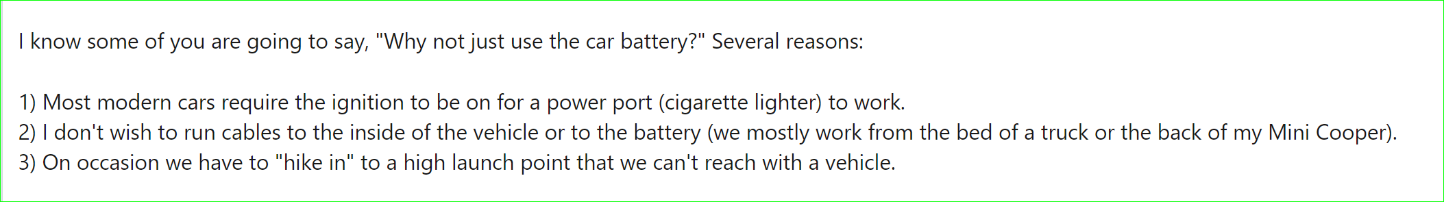

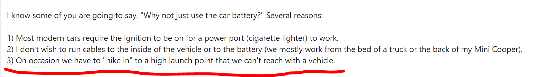

I know some of you are going to say, "Why not just use the car battery?" Several reasons:
1) Most modern cars require the ignition to be on for a power port (cigarette lighter) to work.
2) I don't wish to run cables to the inside of the vehicle or to the battery (we mostly work from the bed of a truck or the back of my Mini Cooper).
3) On occasion we have to "hike in" to a high launch point that we can't reach with a vehicle.
