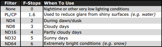

Here are the ND filter sets PolarPro is offering for the P4P:
Here's a guide showing when each ND filter is generally used:
