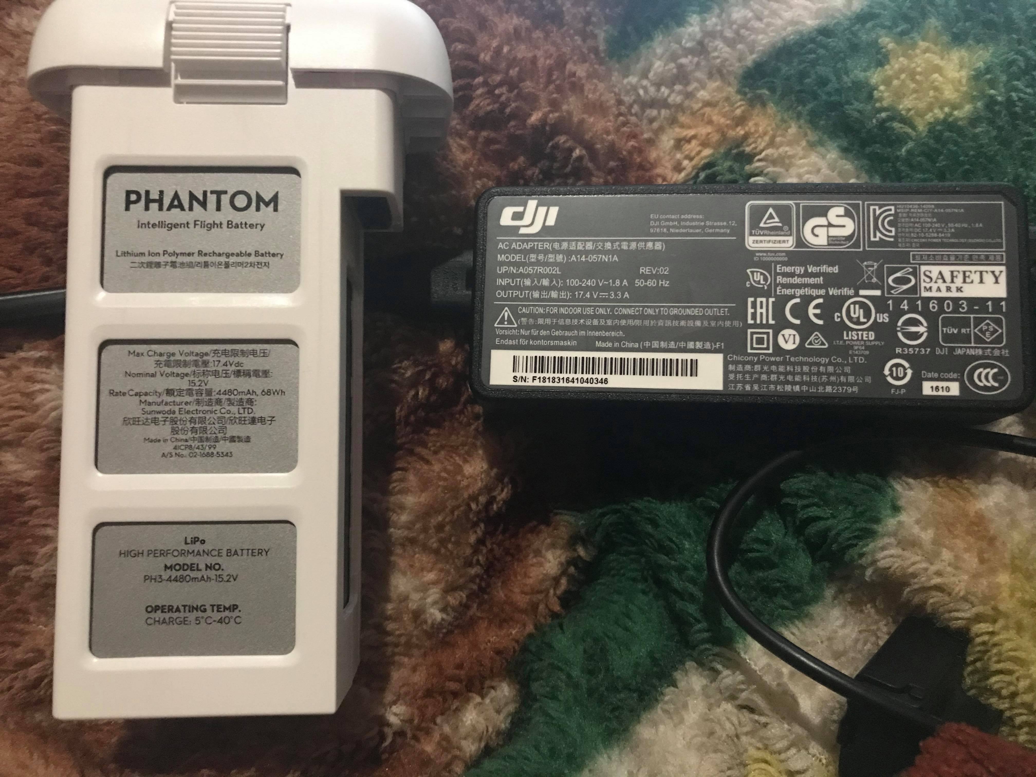

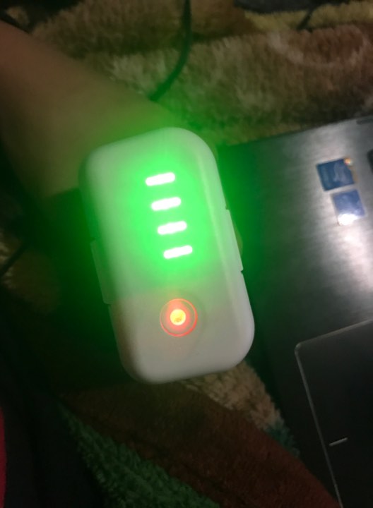

i know its kinda old now but i bought a original DJI Phantom 3 Standard new in its package but it does not take any charge , ive left it charging all morning serveral times and nothing
when clicked 1 time it flashes green 3 to 4 times and suddenly turns off , when 1 click and then hold just turns off or flashes 1 time and it turns off
then when i plug the charger that it came with it lights all 4 green leds 3 times and turns off it just does that i just cant find a solution to this , and the dji store i went told me that it was original but they dident work with them anymore so i cant get a new one , any solutions or should i buy a PH3 non brand battery?

Definitely buy a new DJI battery. You don’t want to mess around with batteries, on less you want your bird falling out of the sky. And new batteries last a long time.

Have you downloaded the FULL manual for the Phantom 3 Standard ? The Quick Guide in the box is waste of paper ... you need the full manual .... just Google : Phantom 3 Standard Manual ...
OK ... try this :
Remove propellers.
Have Controller on
Insert battery fully into Phantom
Switch on Phantom
Start GO on your phone / tablet and then connect via WiFi to Controller
If necessary select Phantom 3 Standard.
Now if there is any power in the battery and all connects - you should have a screen that you can then use the menu to check what battery reports via telemetry..... if you have cell voltages etc. full charge is 4.35V each cell ...
If battery is not powering the Phantom ... switch all off and we try to recover battery from possible Hibernation Mode.
1. Disconnect all items and let battery sit.
2. Switch on battery (only try switching on once - do not repeat) - IGNORE LIGHTS Do not do anything else .....
3. Let battery sit for at least 5 minutes.
4. Using supplied DJI charger - plug in charger to battery - IGNORE LIGHTS
5. LEAVE IT charging or trying !
It may take all day before the charge starts ... but the sequence 1 through 5 is important. If the battery still fails to charge (during charge - the LED's cycle through and the number of LED's that cycle indicates charge level) ... then you can repeat attempt ... remembering #1 #2 #3 ...
If repeat attempts still fail ... then I'm afraid its replace time.
To be honest any battery that goes into Hibernation Mode - I would be cautious about and replace ... keeping it for test / bench / short use only.
3rd party batterys do work ... but there are a few that will not start up the Phantom ... but luckily they are very few and rare. I have 3rd party batterys as do many others ... as well as original DJI ... absolutely no difference at all.
