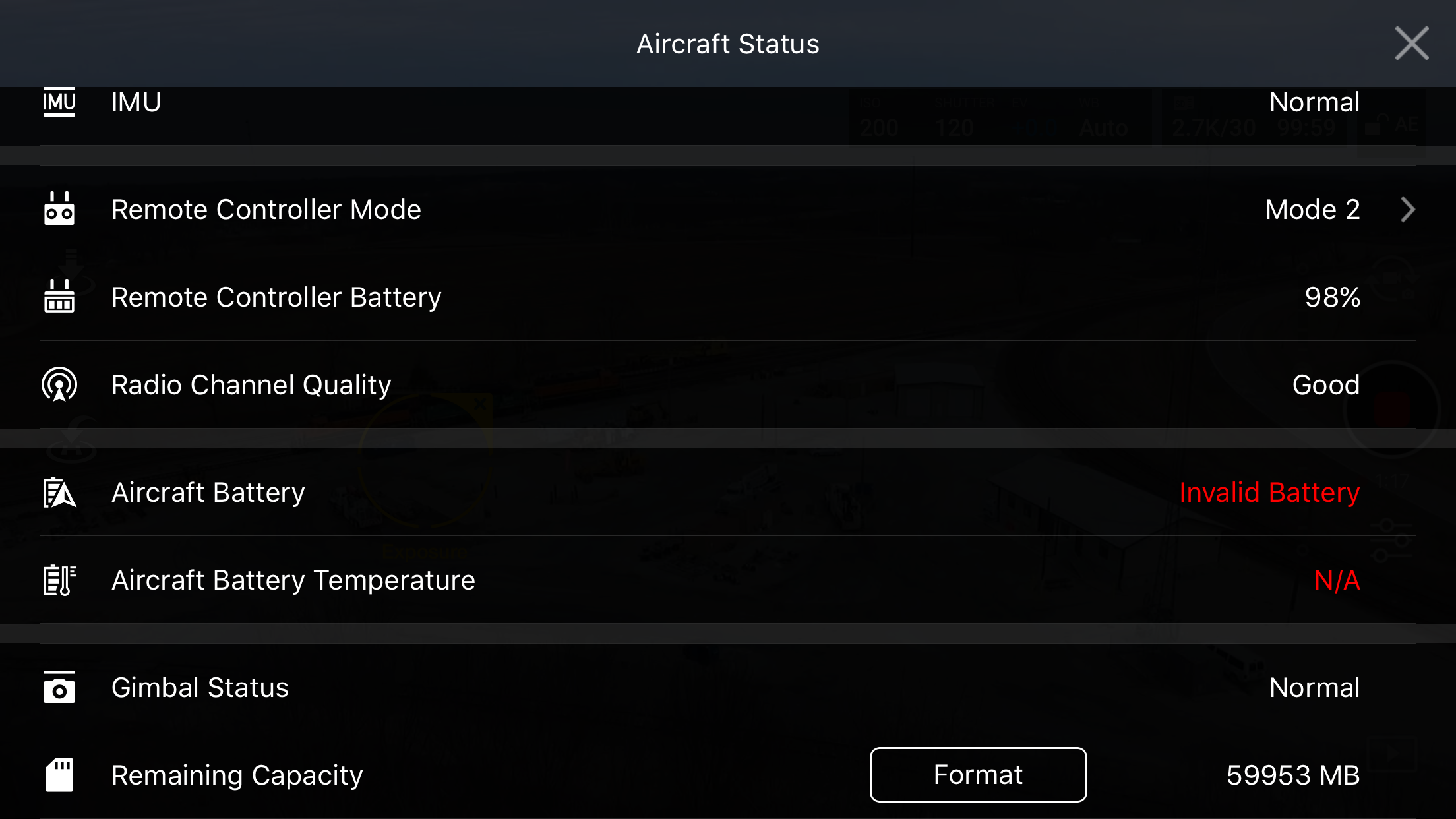

Thanks for the tip. However, when the battery error appears, it doesn't display anything for the cells. Even the battery percentage doesn't update when the battery error is showing in the status bar. For example, it's showed 62% when the battery error appeared, and by the time the battery error disappeared for a bit (minutes later), the battery percentage was below 30%. During that time, the percentage was locked at 62%. And like I said, there is no battery cell information, and it says "invalid battery" the entire time.
At any rate, I got my return shipping label today from DJI and I have sent the battery to them. I'm hoping for a fairly quick turnaround. I made an album with the screenshots and a short video showing the error for those that are interested. The battery error appears at about the 3:45 mark. So for the first few minutes, there is no error, but once it appears, it only goes away for very short intervals, at which point everything is green and looks good. I really think it's just some kind of communication error and not an actual problem with the cells. When the error goes away, everything looks good. When I check the cell status on the battery LEDs when the battery is out of the drone, all the lights show up. And it charges to 100% just fine. I'm hoping DJI doesn't tell me there is nothing wrong with the battery. I would be skeptical myself if I didn't have another battery that isn't having the problem at all.

I purchased a DJI refurbished Phantom 3 Standard and activated it on 1/17/17. A few days ago, I got a battery error in the status bar during flight, and when I clicked on it, it said "invalid battery". This is with the OEM battery that was included with my P3S. I contacted DJI online support, and they asked me if it was charging okay, which it is. The LED's also do not indicate a problem, so I was hopeful that it was just a random glitch. DJI told me to fly it again and take a screenshot if it happened again.

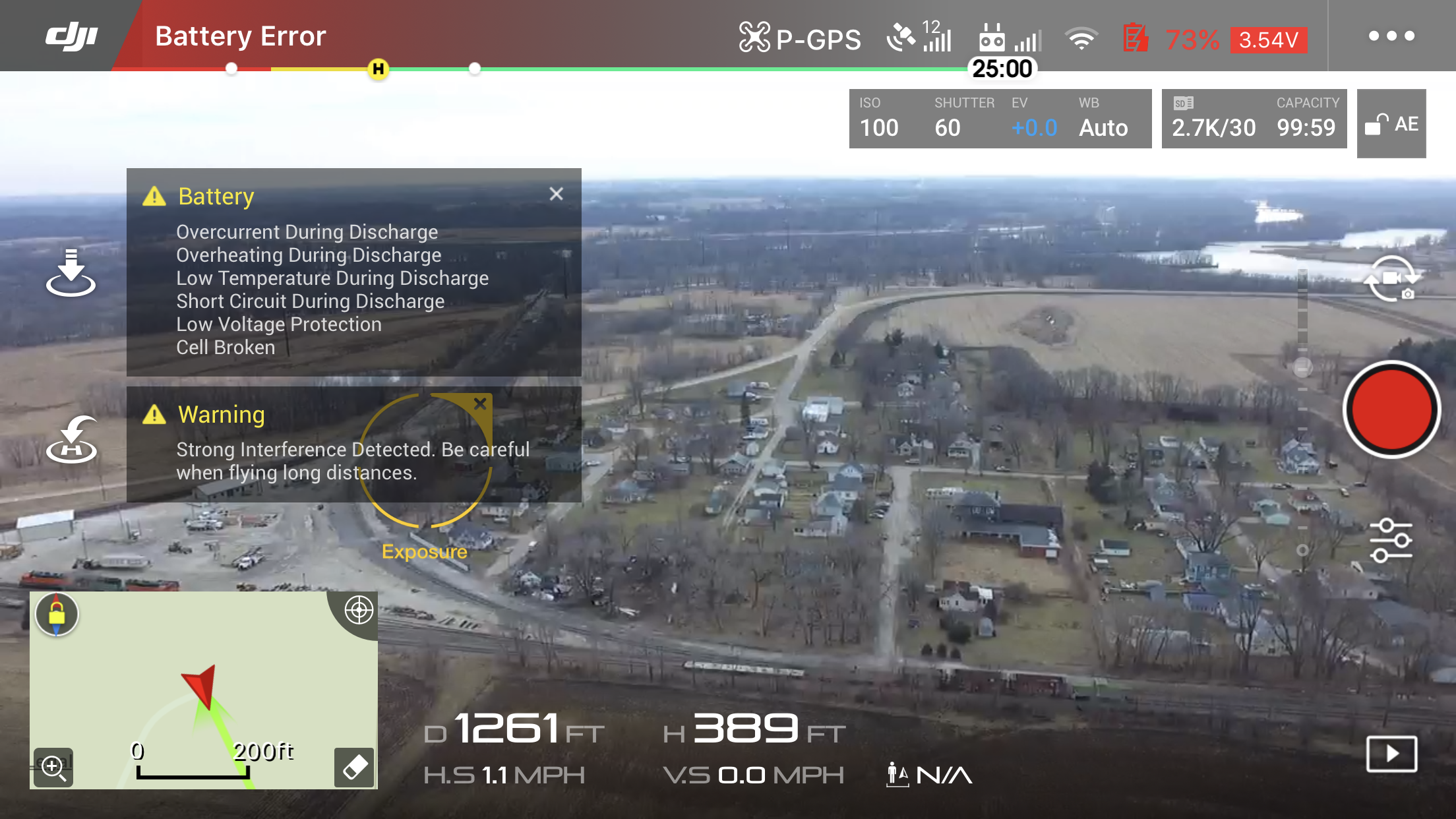

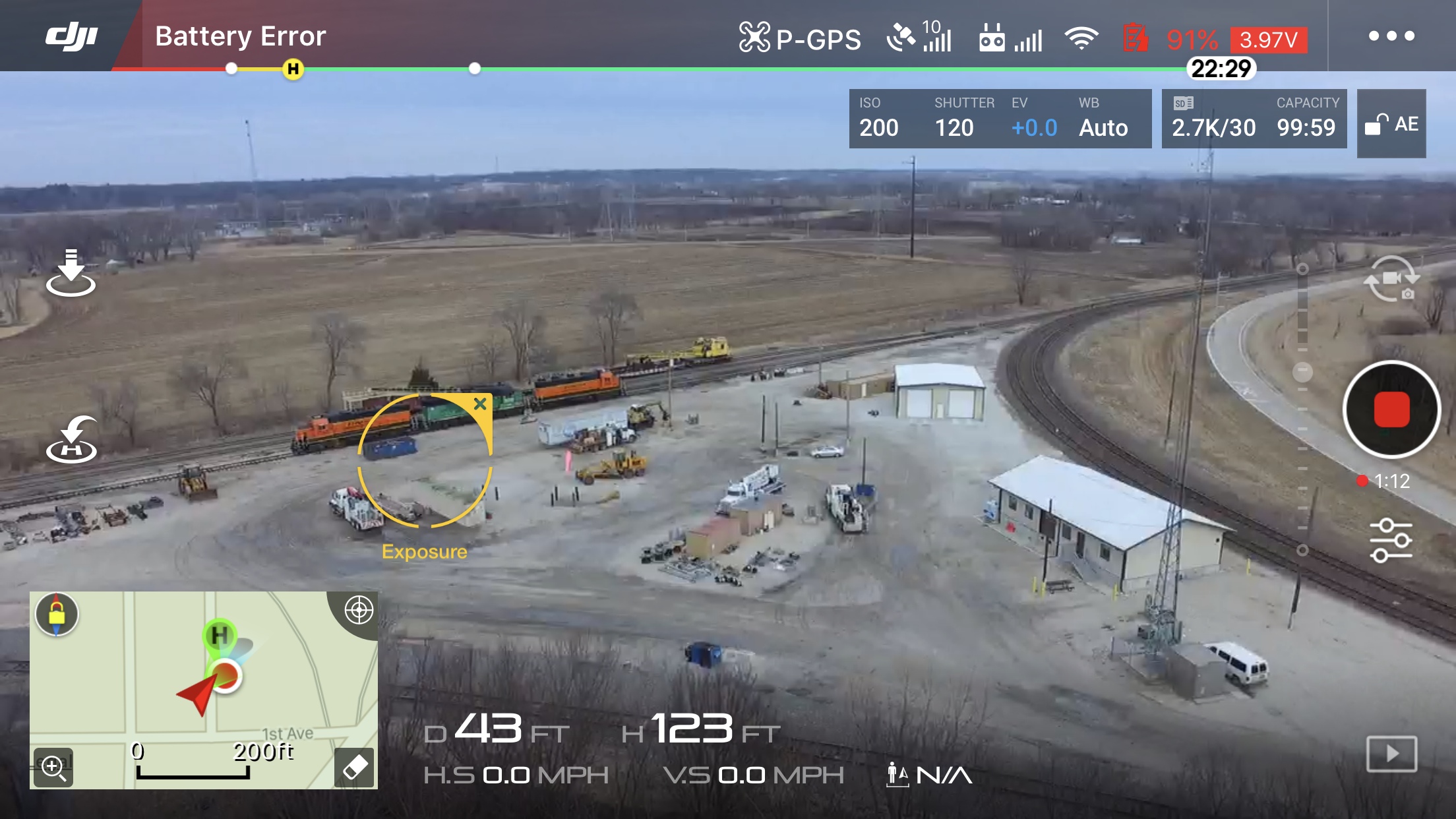

Today, I flew with the battery again after charging it to 100%. Shortly after takeoff, I got the same "battery error" message in the status bar and it again said "invalid battery". I decided to land, power off, remove and reinsert the battery, and try again. Same thing happened, but I kept flying because the Phantom seemed to be operating properly otherwise. The message would disappear and everything would turn green again, only to have it reappear again less than 30 seconds later. After a while, I got multiple battery error messages on the screen and I knew that was my cue to land.
I was just wondering if anyone has had this same problem and what could be causing it? Again, the LED's on the battery do not indicate a cell problem, and the battery is charging normally. I have initiated a warranty replacement and currently await the shipping label. But in the meantime, I wanted to educate myself a little better on the battery problem.
Here are the screenshots I took. The last one looks like it just spit out every battery error message possible, no?
