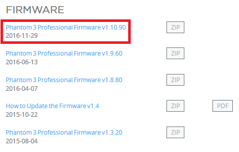

Where did you get 1.10.90?
On the DJI site, the latest is 1.10.0009.
1.10.90 is the current firmware version. You can download it from the P3A downloads page or the P3P downloads page.
The filenames can sometimes be confusing. 1.10.90 is definitely the current version though. You're good to go.
