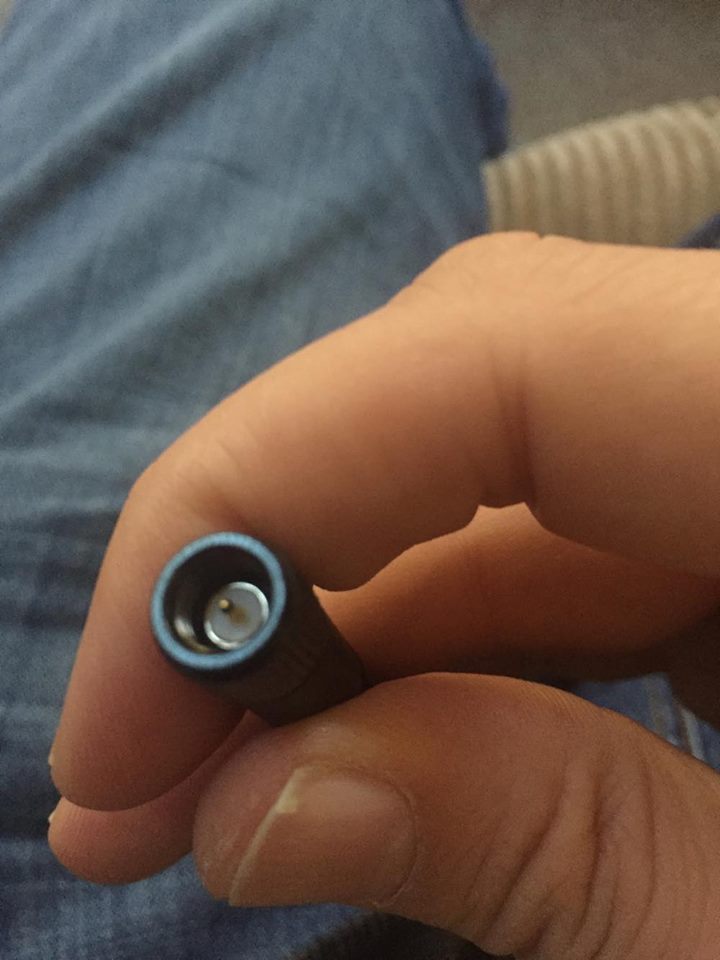

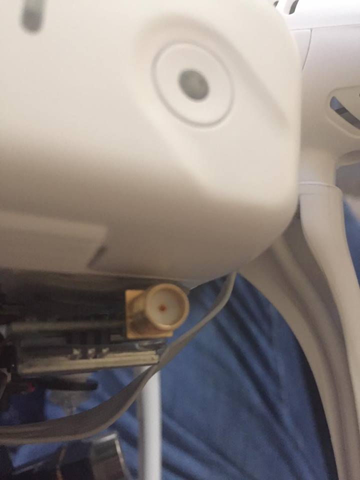

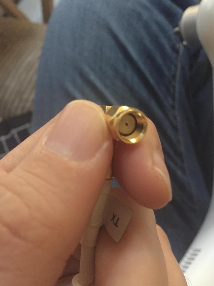

The antenna jack on the TX is a "female" style plug and the dipole antenna that is comes with has a "male" plug.
I do still have the cloverleaf antenna that came with the AVL58. However, that plug is also "female".
So, the question is, when it comes to antennas and transmitters, does it matter between male and female? Can I only use the dipole that came with the Immersion, or can I also use the cloverleaf? Obviously, I don't want to burn this one out because I used the wrong antenna.
Here are pix of all three
View attachment 35746 View attachment 35747 View attachment 35748

If you what to use the AVL58 cloverleaf antennas you can but you will need the the correct adapter as both the antenna and TX are female.
1pce Adapter 90° RP.SMA female plug to SMA male plug connector right angle M/F
