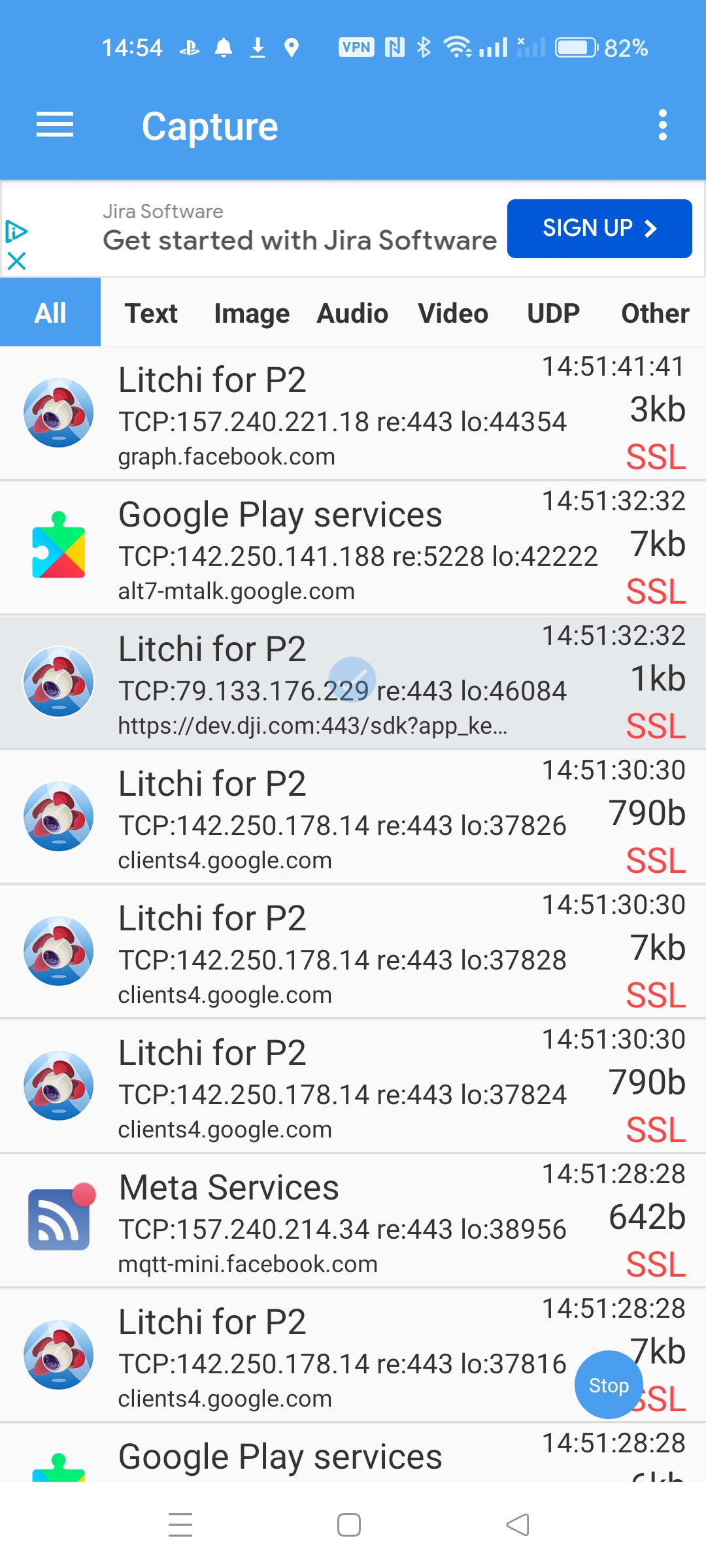

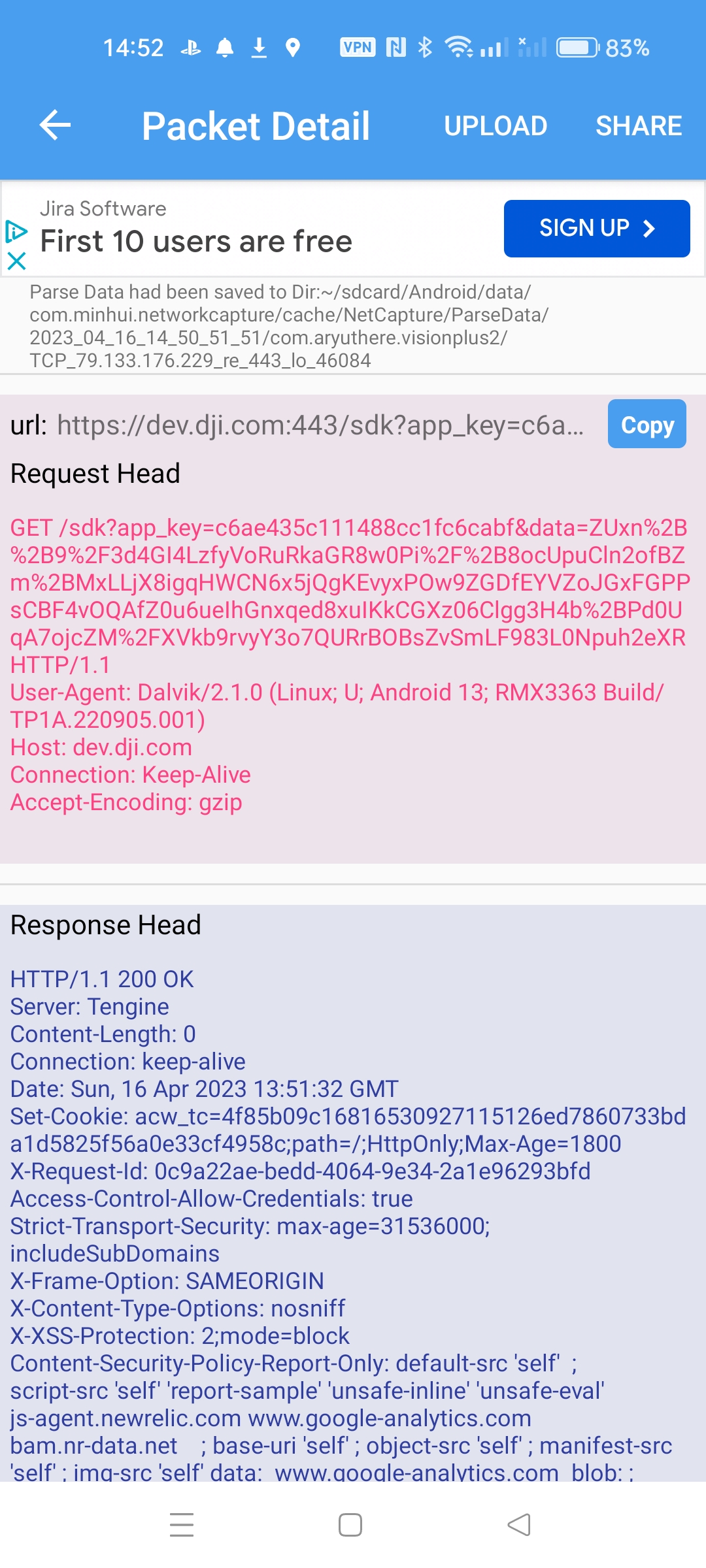

So for anyone who might want to play along with getting Litchi for Phantom 2 Vision Plus working again, I ran NetCapture on my Android phone and then launched Litchi for P2V+ and looked for the call out to DJI to try and authenticate the application key and you can actually see the call it is making and the response it gets
The first few calls are out to Google, which I guess is the Android App authenticating itself and updates etc and then the 5th call you can see is to https://dev.dji.com:443/sdk which is the SDK authentication server for the SDK that Litchi was built with
This then gets a response from the server of Length 0 which is why Litchi is failing to start as it is expecting some positive handshake back from the server (*what this should be is unknown) so in theory if we can find what this is then we can overwrite the URL with our own server response and actually activate Litchi correctly on startup

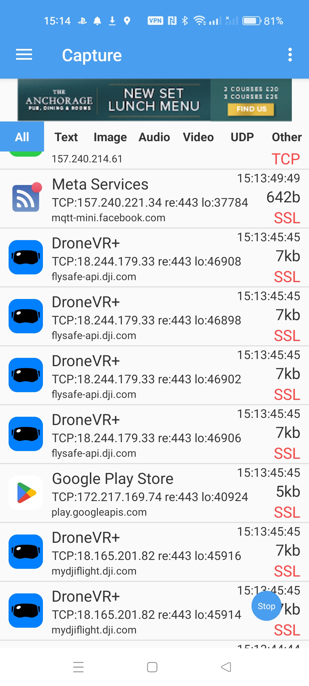

Just did a quick analysis of DroneVR and it's using a later SDK I would think as it makes an initial call to https://mydjiflight.dji.com/ and then follows this up with calls to https://flysafe-api.dji.com/
The response is over SSL with a GoDaddy certificate so I think won't help us with the Litchi response we need
