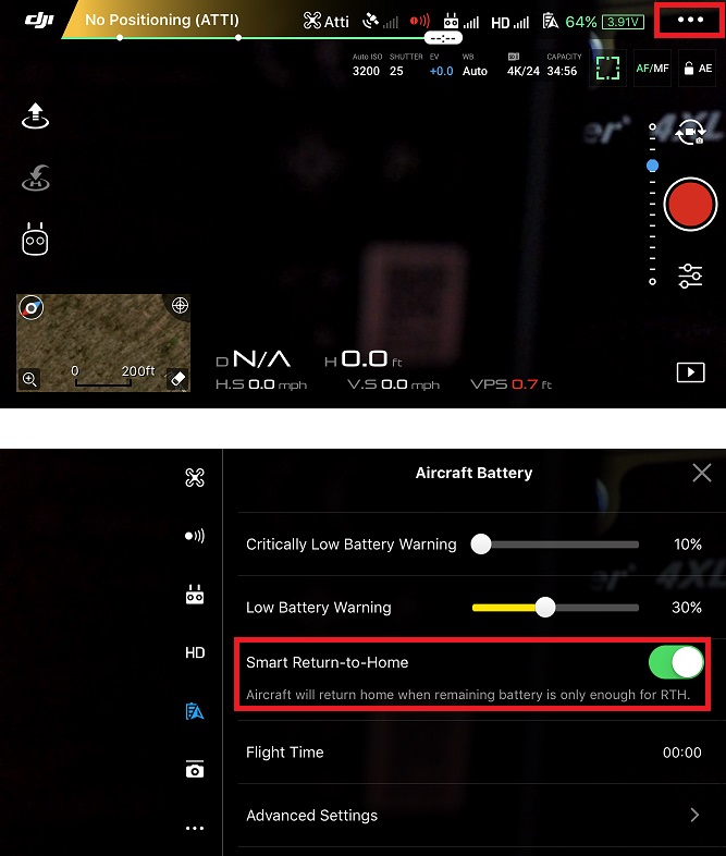

The Phantom will only attempt to auto return home if the following setting is enabled in DJI GO:
Keep in mind that the Phantom is not able to account for current wind conditions, so you should manually head back to the home point before this feature kicks in if it's windy (even more so if flying into a headwind on the way back to the home point).
The low battery and critical battery warnings (shown in the above screenshot) can also be set to have DJI GO alert you when the battery reaches the set levels.
@BigAl07 I already have both low battery alerts set (30% and 15%). My question was about an automatic return to home, in case I was distracted by other work, but I take your point.
@msinger I can't find the smart return to home option on my Go 4 app? I have the P4A, does that matter?

It's not possible to adjust when the Smart Return-to-Home and auto landing at critical low battery events occur. The low and critical low battery warning settings only allow you to adjust when those alerts appear in the DJI GO app.

Ever try that? All it does it display the battery alert sooner. The auto RTH is automatically triggered based on the distance and altitude of the Phantom.
