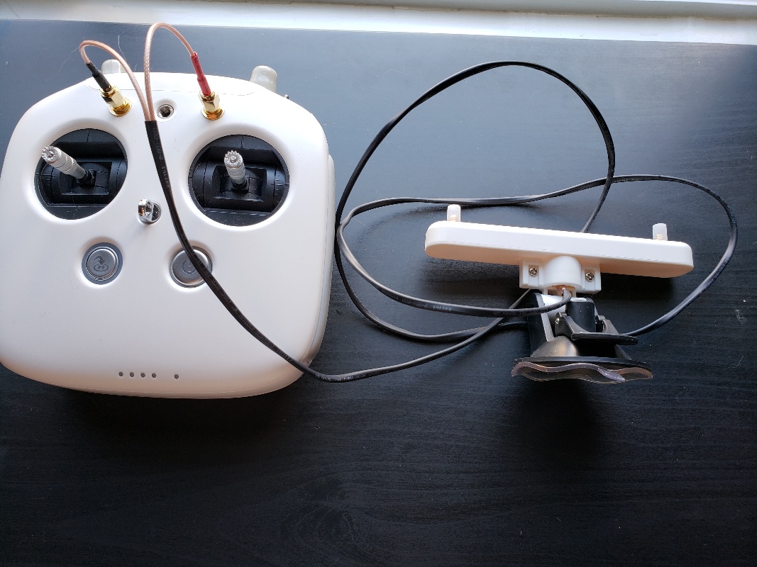

I got one of those kits that "extends" your antennas so you can mount them on top of your car. It allows you to fly from inside your car and stay warm in the colder weather. I attached a picture (picture is for a Phantom Standard.. could not find one for a Pro). So my question is this... is this thing going to work ?? I'm thinking about the antenna mounted (rubber suction cup) on the metal roof. Will it degrade or mess up the control signal at all?

Here's a picture of the actual product.....

Here's a picture of the actual product.....View attachment 104980

I got one of those kits that "extends" your antennas so you can mount them on top of your car. It allows you to fly from inside your car and stay warm in the colder weather. I attached a picture (picture is for a Phantom Standard.. could not find one for a Pro). So my question is this... is this thing going to work ?? I'm thinking about the antenna mounted (rubber suction cup) on the metal roof. Will it degrade or mess up the control signal at all? View attachment 104979

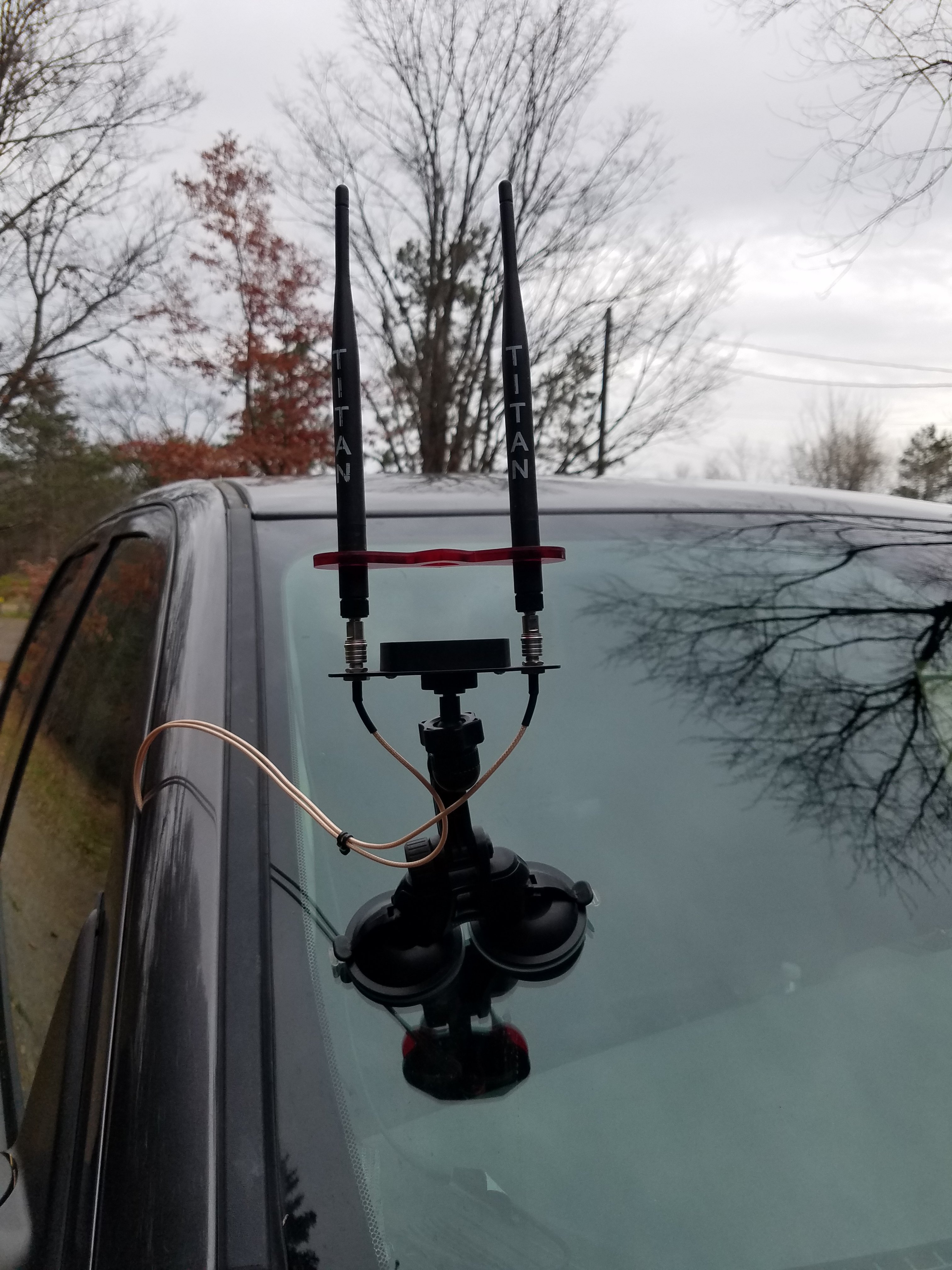

I have this argtek range extender + car kit for my P3P but disappointed with the range. I live in a city with a lot of interference, tested the RC kit at different locations, signal usually started to drop from 1KM out and the max I could go is 1.5~1.7KM. When I connected the car kit my range reduces significantly, at one location I did a few times range tests, with the RC kit I could go 1.5KM, with the car kit it could only go 700m.
I think you going to find that is exactly the same as standing outside your car and flying it.
We use the Reflective Shield to fly inside the car and that works ok but magnetic interference is much more your enemy than any range your going to get .
Because the controller is inside the car, you sill have all the same problems to negotiate when you fly in or around a car . we also fly from inside the house with the same results.
So yes its going to work but not with the magic you think you might get from it.
