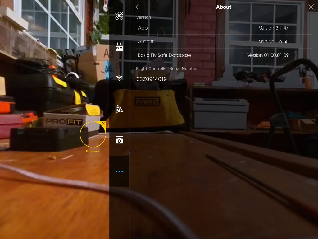

OK I just went and got it out and powered it up. Now I did not see no update bar and thought it was all current and here is what I show on mine .
Thank you for taking the time to do that. On mine I am not seeing the version number, or remote number both have N/A. I also cannot set any of the settings like fly home altitude max alt etc. None of that is being seen by the app. Yet the bird will fly and must be getting some kind of gps because it will hold in one place. Even though there is no battery data or gps data anything. I think like a mechanic. Something screws up what was the last thing that was done? The update. I feel that the update may be corrupted or did not install properly. My big question now is when this updates I mean firmware. Does it download onto your app and then transfer to your memory card in the camera where it is installed to the hardware? Is that how it works? Can I download and replace the bin file on my sd card with a new file will that initiate a new install? Or do I have to ge back one and then forward one? Im seriously thinking this is all due to the **** update and of course it is and you know DJI wont take any responsibility for screwing up a perfectly good flying machine with its updates!
