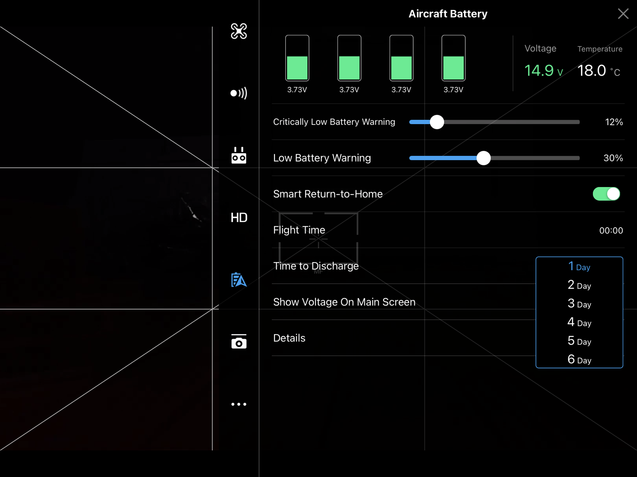

The Go4 app will do it for you.
I think you are trying to say the batteries are programmed to automatically discharge down to the storage level when not used. Can you clarify?
Yes, I believe there is an option in the battery menu as to how long the wait will be before automatic discharge. You can set it to one day.
The weird but also the great thing about DJI batteries, is that they each have their own cell balancing and discharging functions inside each battery. I'm not saying that they are great examples of those functions, but they are there. You can go into DJI GO4>Aircraft Battery>Time to Discharge and set whatever battery is in the drone to self-discharge from 1 to 10 days after the last charge. See photo. This setting gets saved in each battery, not the drone it's in, so you'll need to set each battery separately. However, after you have charged, the time until discharge will get reset if you press the button on the battery, to check how many green lights for example, before it starts to discharge. So if you have it set to 2 days and waited 1 day and press the button, it will now take a total of 3 days before it starts to discharge. You'll know if your battery is self-discharging when you pick it up and it is warm. Each battery has what I'm guessing is a small induction heater inside which bleeds off voltage until it reaches a safe storage level. This may take up to a couple days. I believe that DJI wisely put this function into each battery because storage at full charge even for just several days repeatedly can be quite damaging to lithium cells and most consumers don't want to be bothered by lithium battery care.

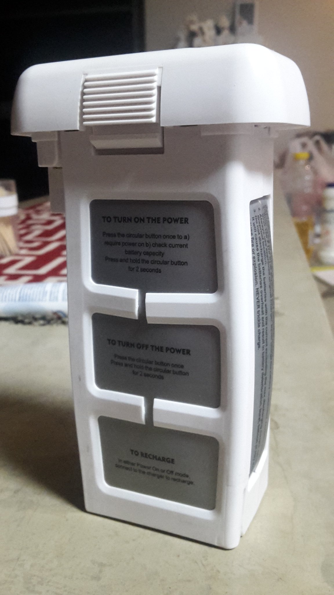

Attached is a picture of a puffed up/bloated lithium DJI battery. My guess is it was either left at full charge for weeks or charged when it was still hot from a previous flight.
