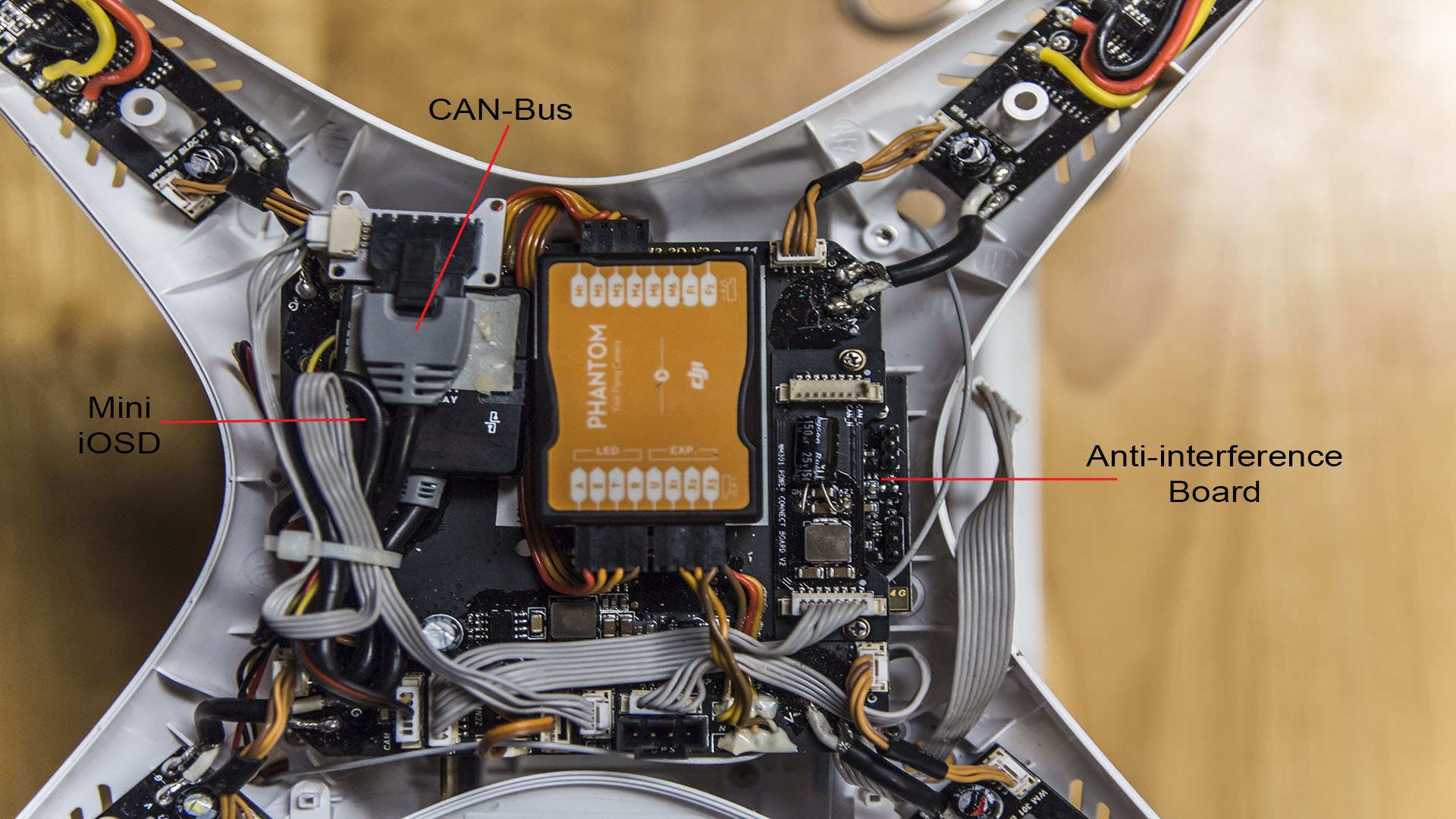

Hi
Phantom 2 owner, joined today and this is my first post. I believe this must have been asked before but where are people fitting their anti interference boards? Inside the body or outside? Any advantages, disadvantages to either. I noticed the DJI how-to video put it on the outside.
Thanks

The anti-interference was designed to go inside the P2 right over the P2s receiver. Its sole purpose was to stop noise interference in the video output Of course it never really worked that well.

If you want it inside you will need the longer 8 pin cable that will run from the AI board to the Zenmeuse, the one supplied is to short, as Jason says, remove the 2 screws on either side of the TX board and fit the AI board there then screw it down

Your statement that the cable that came with the AI was to short is incorrect What needs to be done is to remove the 8 pin cable from the left and reroute through the right motor mount hole. As in the following photo.
