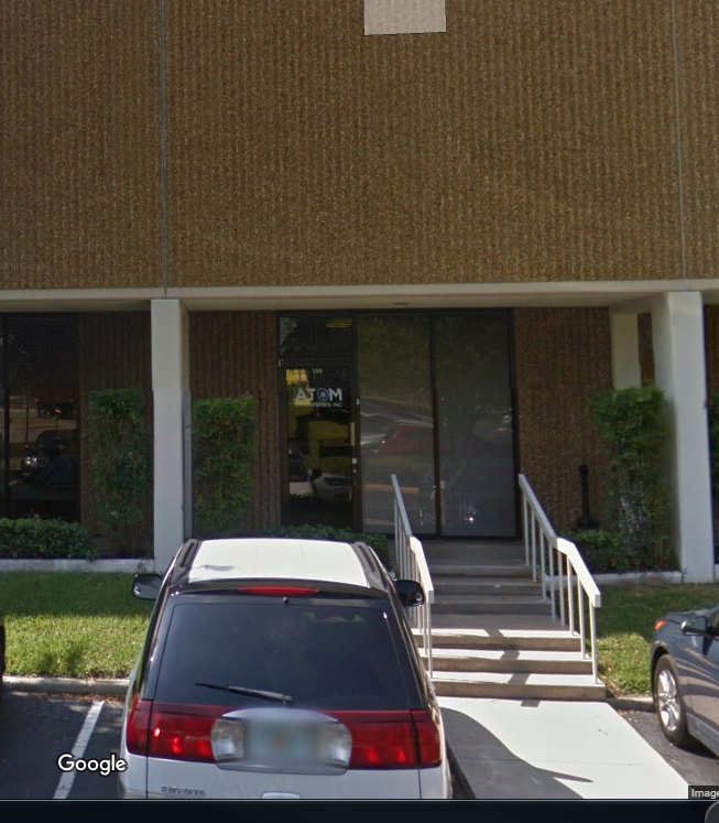

I looked them up on street view. 8100 Chancellor Dr., STE 150, Orlando, FL 32809
They must be new at this location, the sign at suite 150 doesn't match.

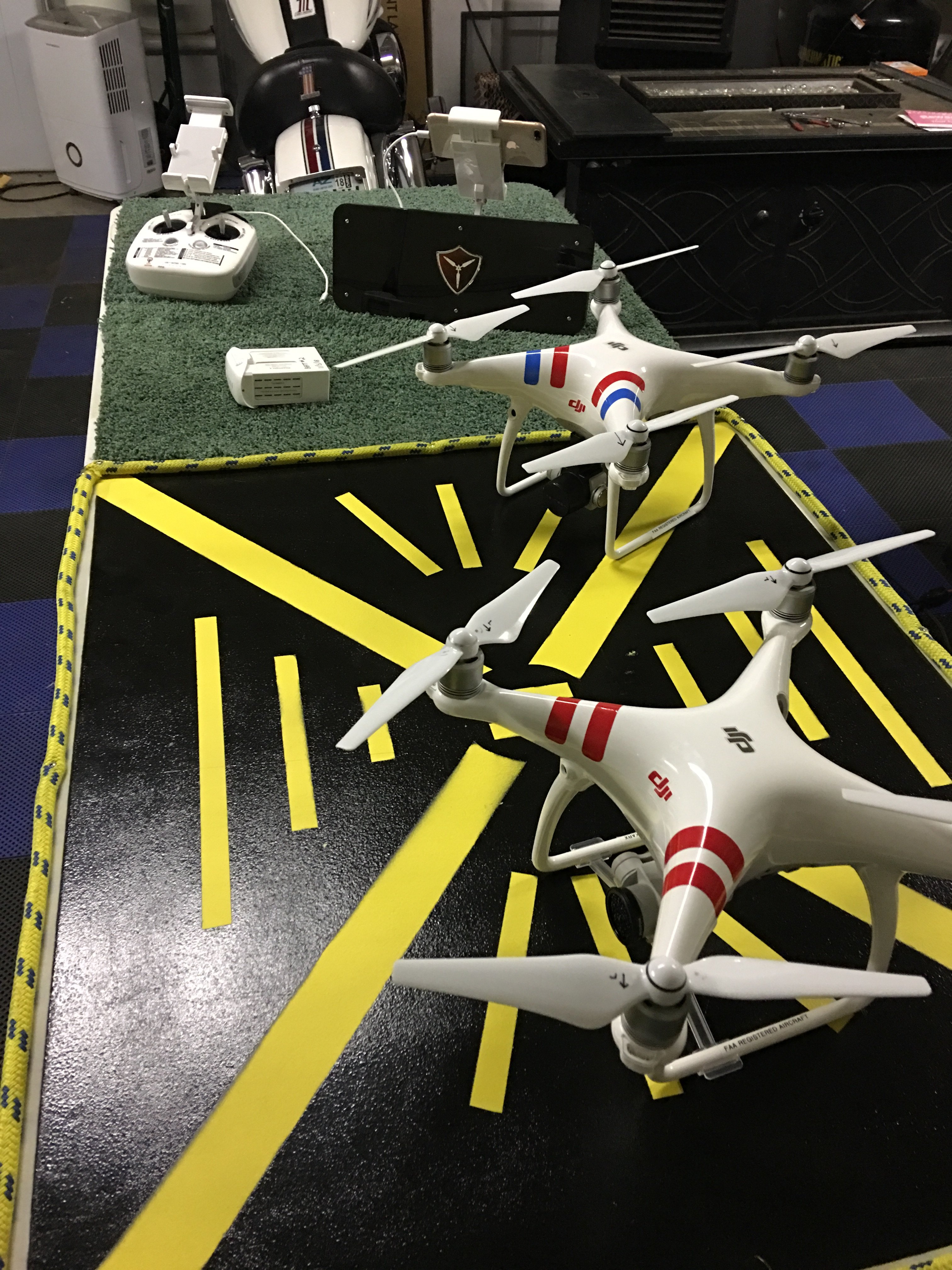

Getting ready to see how the Conqueror performs on the P4 standard and P4 Advanced today. Waiting for it to warm up a bit as below 60 is freezing for me in Arizona. Excited to see what the results will actually be.
View attachment 95176 Getting ready to see how the Conqueror performs on the P4 standard and P4 Advanced today. Waiting for it to warm up a bit as below 60 is freezing for me in Arizona. Excited to see what the results will actually be.
Wow, that's a big antenna. You should get some good range with that beast. You only need an iPad that big and you'll be set!
Nice Harley.
Thanks John on the scooter, 06 anniversary FXDI35, and yes the Conqueror is huge ! Ya know...BIG. Sitting here right now waiting for a little more favorable conditions to launch out over the desert here at the house and see how well the system works on both aircraft. The wind is working against me for a real test at the moment, always seems to happen when you want to try something new. I’ll be sure to post my results as soon as I can test it out.
You will outfly your batteries. The Conquer is big and a little heavy but if you set up and fly from a table or platform it is no problem. Anxious to hear your results.
WWK888, question sir. Because of the shape of the Conqueror do you find you have any issue if it’s directly overhead about 300 feet altitude? Wouldn’t mind knowing before trying. Thank you.
It is directional so it may lose signal momentarily but I find it is pretty forgiving. Not a real problem if you lose signal overhead, just angle it up a bit and will reconnect very quickly.
Thank you sir. Go sit outside now and see if I get a window of opportunity. Sure hope so.
