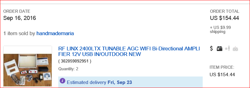

I snagged a pair of these yesterday
Thanks for posting. I just grabbed two from the same seller. Ended up paying $45 more than you tho! These look huge so I imagine I will make them a part of a dedicated install in my suburban and if I can get the other amps working, I'll use those when I backpack somewhere.
Now they are $150 each. Still more than half off new though.
