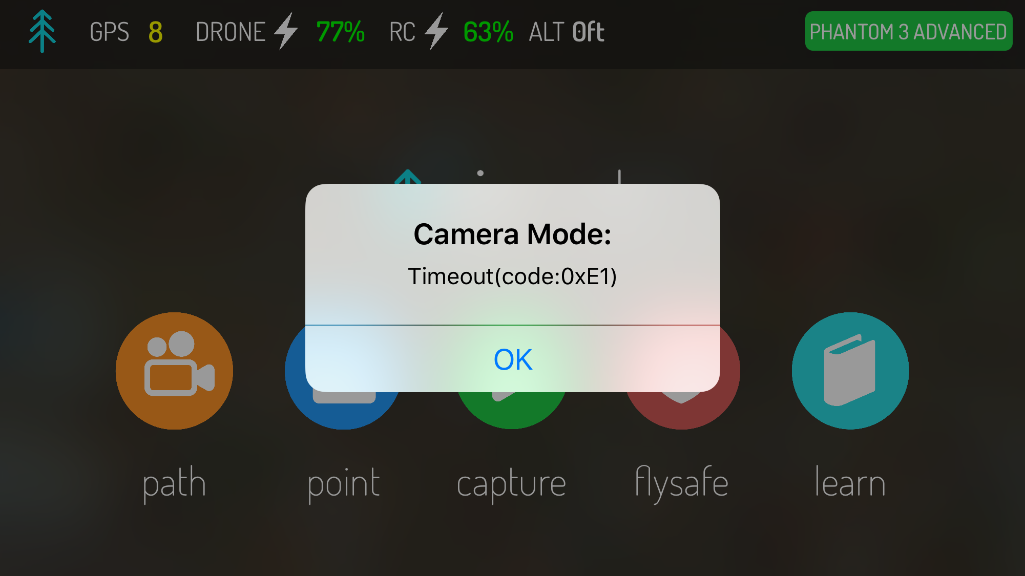

I once got this "Camera Timeout error" But only once.
Ideas anyone?
The timeout was likely the drone lagging when setting the camera to capture mode (this is incase you were in playback mode from another app).
When you get a blank video screen try swiping it to video or photo mode and then back again and see if that fixes it. I am going to be posting a quick beta if anyone here with video issues wants to try it, the only change for this beta will be to fix this issue.
