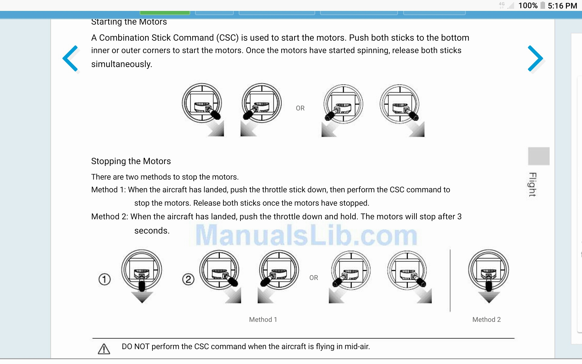

OK......a simple question : Do you get all 4 props on the right motors....the spinner of the props color should match the color on the top of the motors shaft...and are you staying on the sticks too long after the 4 motors start to spin ??

Thanks Anisa...the creator of the video is just ONE of my favorite posters here....He did a nice job of showing the ease it can be done....To a new person with broke props... and not knowing to watch the colors coding........he would only think that slight bit of effort is a good thing...."Fly Onnnnnnnnn !
