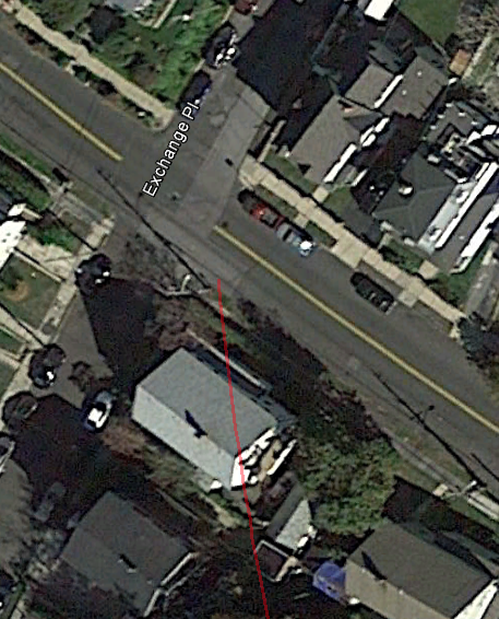

Here's one from 3 weeks ago.Had a look at the txt log.
What caught my attention is the amp draw. The average draw in a normal flight is usually around 15A. In your flight there are three spikes at 50A and a last one at over 60A!
Furthermore the volt spread (the difference between min cell voltage and max cell voltage of the 4 cells) spikes at over 0.20v which is very high. Anything above 0.1v is usually a sign something is wrong.
Seems there was an issue with a motor. At the end of the flight all battery info is flat (volts / amps) but in the last seconds you see a voltage dip. Possibly the battery shut down right after that.

Could you post more of the txt logs you had prior the fly away that had compass errors?
Phantom Log Viewer - PhantomHelp.com
