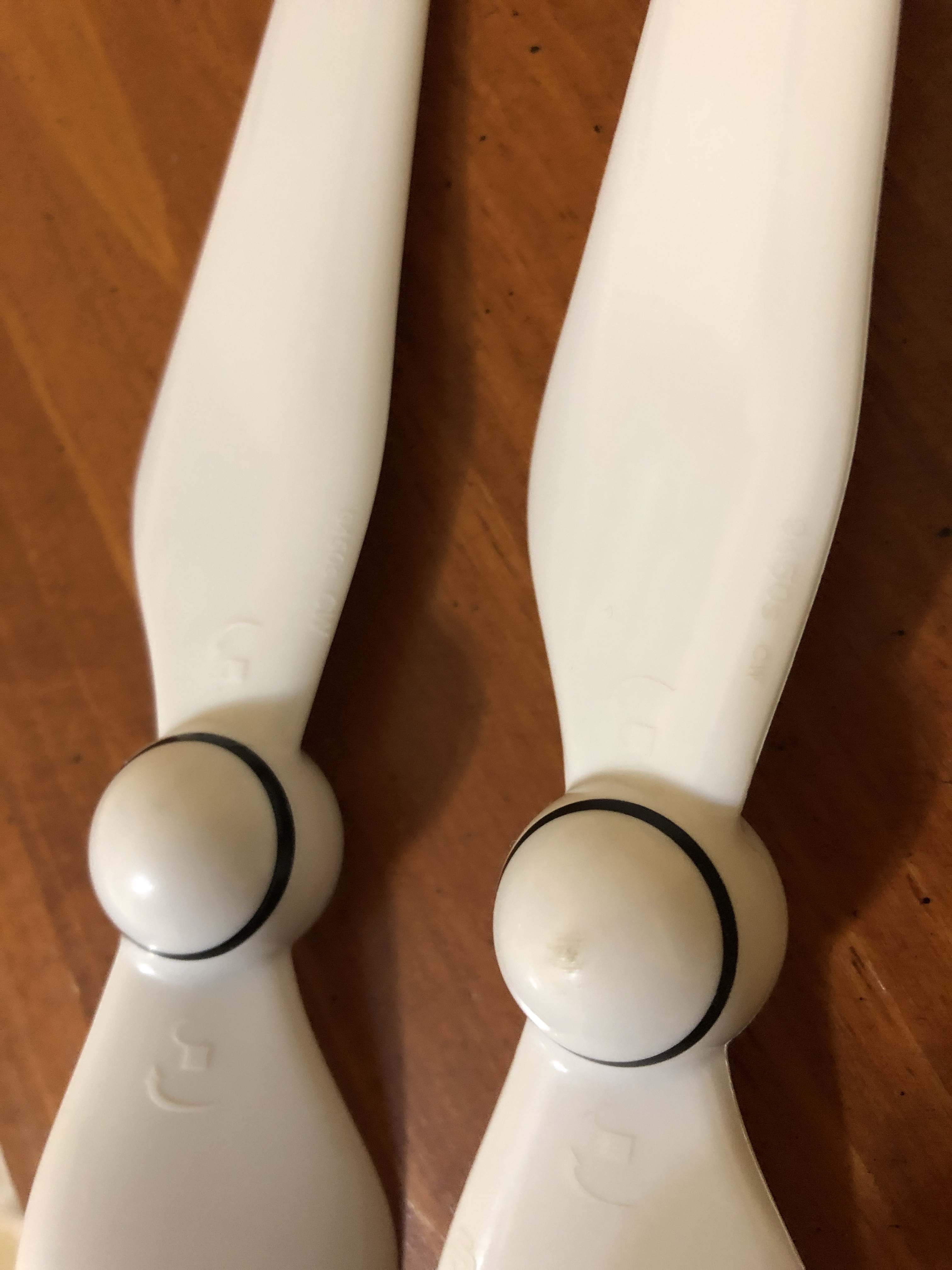

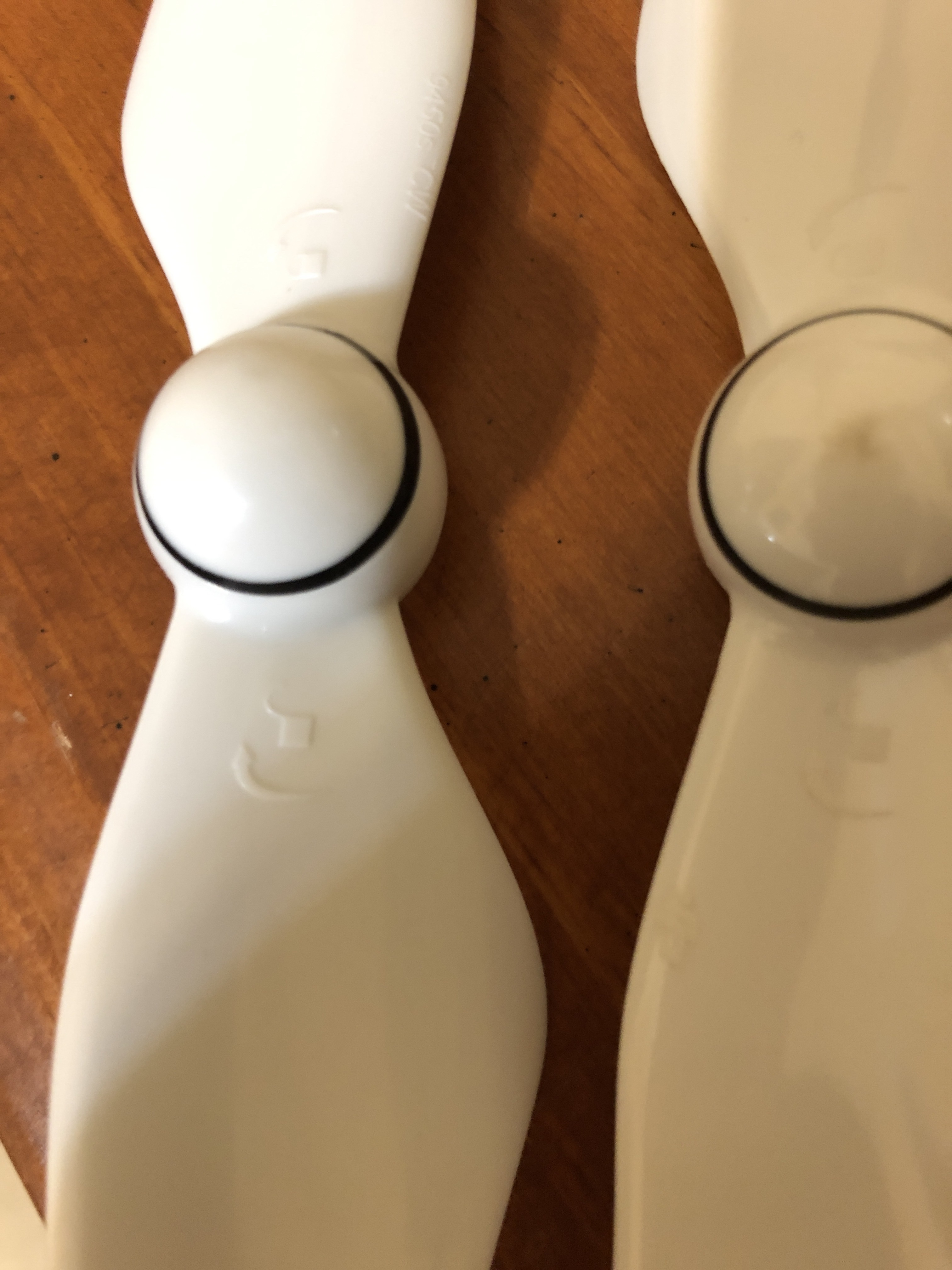

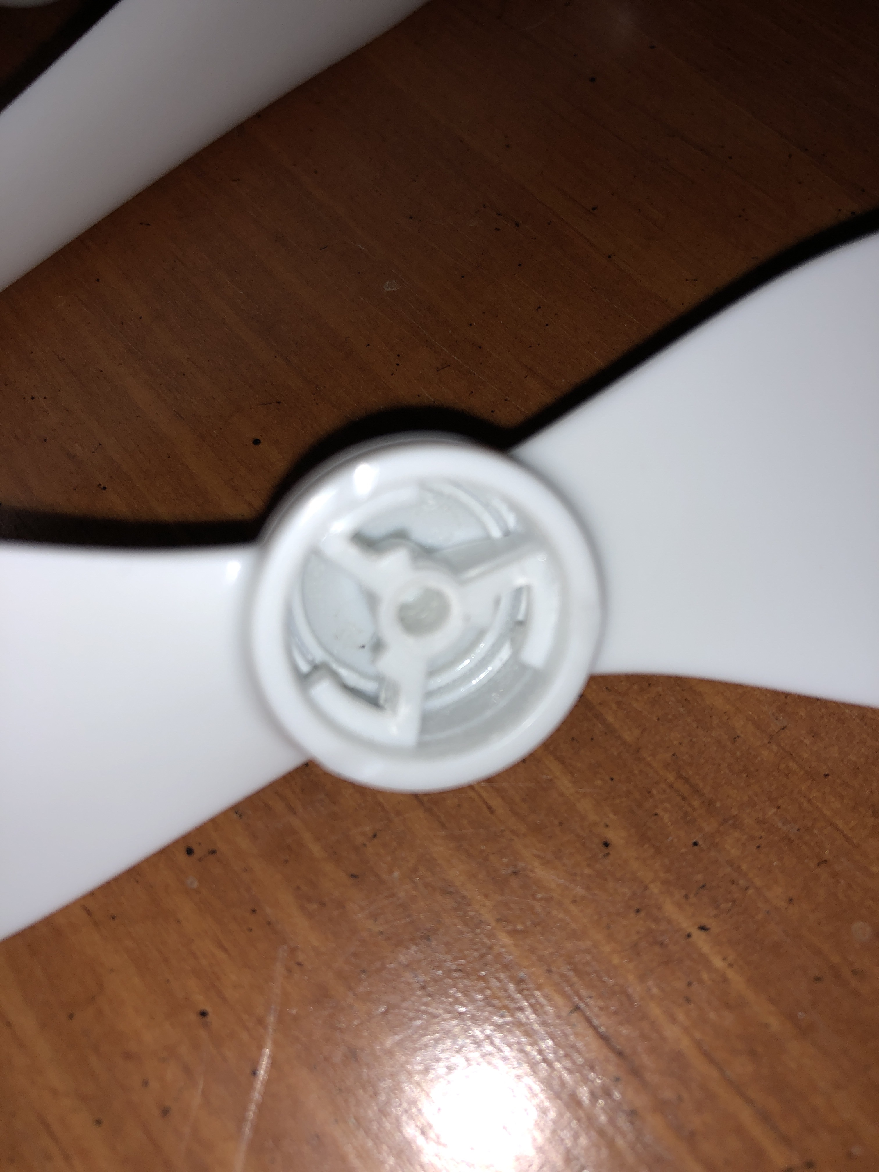

Was flying and after a particularly windy flight, I brought my P4S in for a landing and I heard a grinding noise. Turns out it was a prop striking the body. Upon closer inspection 3/4 of my props had a 6mm vertical wobble, and the undersides were covered in fine plastic dust. I had actually forgotten I got those props on amazon, and they even had the same dji part number on them, but they were missing the dji logo (see below),
and crucially, they were made out of a more brittle plastic that is quite susceptible to wear. The props didn’t even have 6 hours on them, but had I not found the problem sooner, they may have led to a prop coming loose in flight.
Just a reminder to shy away from non OEM props, as some clearly aren’t tested/up to the standards of dji in terms of safety and reliability.
