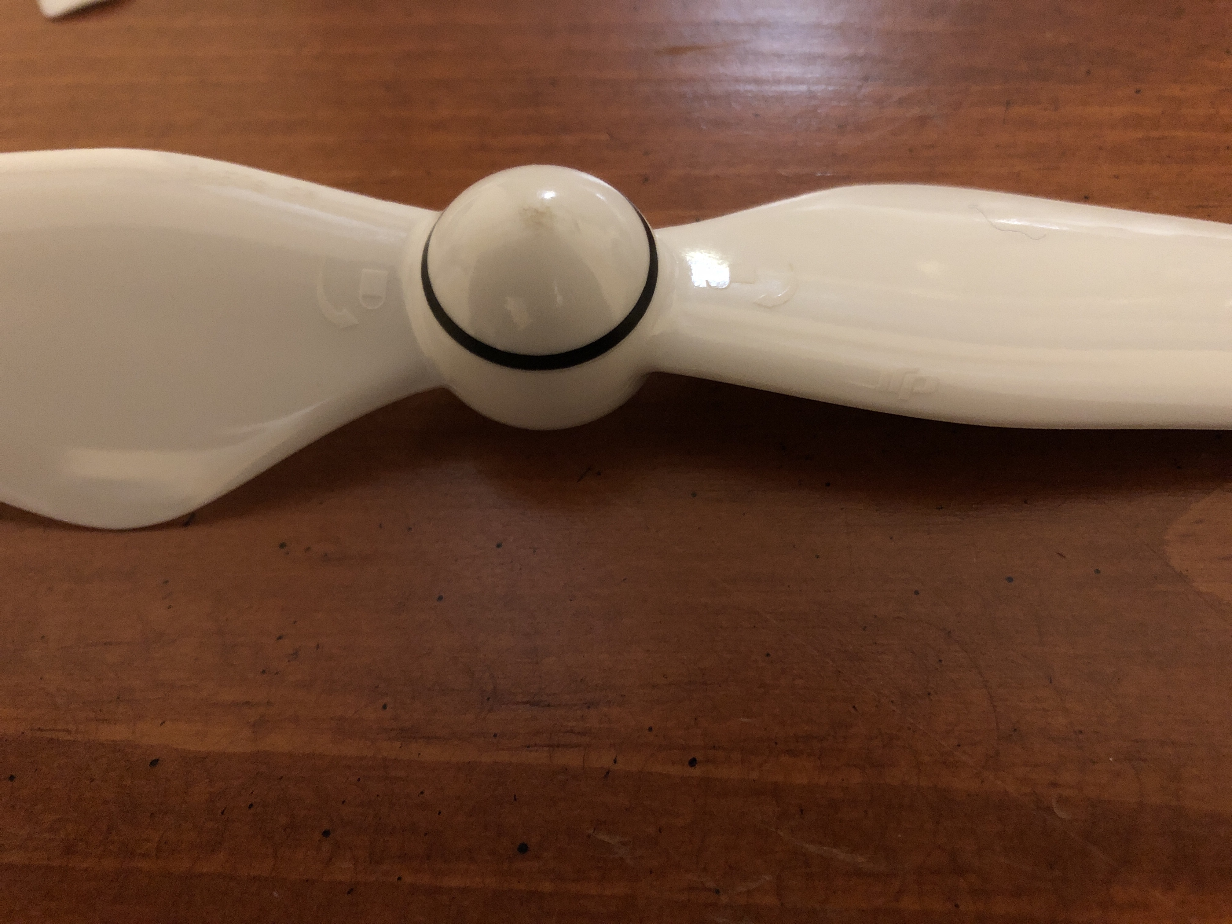

Was flying and after a particularly windy flight, I brought my P4S in for a landing and I heard a grinding noise. Turns out it was a prop striking the body. Upon closer inspection 3/4 of my props had a 6mm vertical wobble, and the undersides were covered in fine plastic dust. I had actually forgotten I got those props on amazon, and they even had the same dji part number on them, but they were missing the dji logo (see below), View attachment 107780 and crucially, they were made out of a more brittle plastic that is quite susceptible to wear. The props didn’t even have 6 hours on them, but had I not found the problem sooner, they may have led to a prop coming loose in flight.
Just a reminder to shy away from non OEM props, as some clearly aren’t tested/up to the standards of dji in terms of safety and reliability.

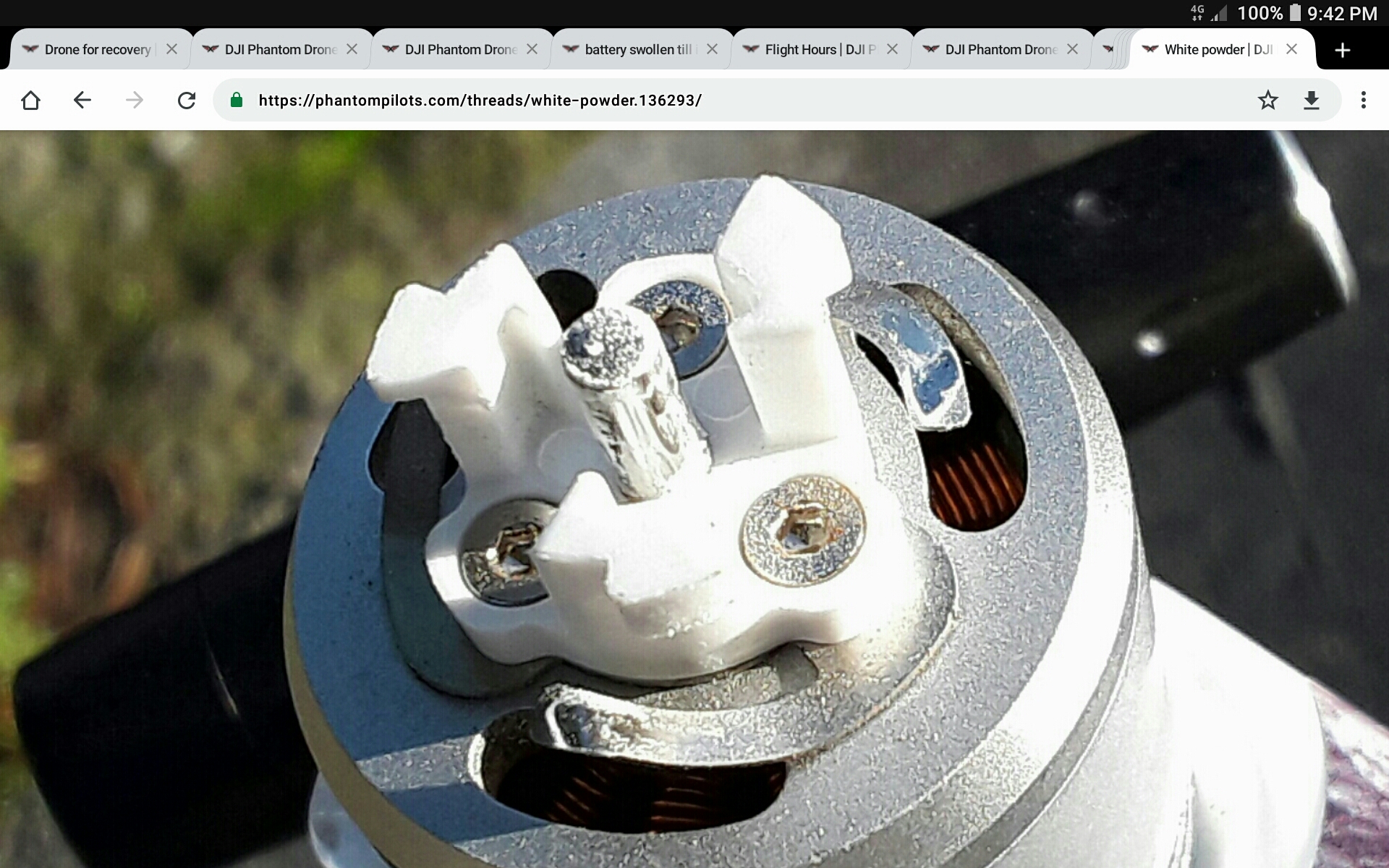

HI hey I had issue back in June, the thread was called "WHITE POWDER" it turned out the play in props was cause by me plastic prop locks being just worn enough to move,,upgraded to p4p spring set up and no more powder or residue, alot better than original set up,,

HI hey I had issue back in June, the thread was called "WHITE POWDER" it turned out the play in props was cause by me plastic prop locks being just worn enough to move,,upgraded to p4p spring set up and no more powder or residue, alot better than original set up,,View attachment 108007
Manufacturers usually change parts for two reasons, better performance/reliability or cheaper production cost. It’s likely the former in this instance. @Forgotten_Fox will probably find his issue was more attributed to the mounts than the props he is suspicious about. Particularity is the ones he suspects as below spec are those with the DJI logo.
I pictured an oem dji prop to show what they should have. Mounts are oem. Props were from amazon without dji logo, and made of a more brittle plastic while being identified to dji props in every other way. I fly with only oem props now and have no issues with the mounts, props, or dust.
That’s an important clarification. It Was a struggle to understand why you might post a pic of an OEM prop to demonstrate an issue with after market- hopefully anyone with a P4 would know what OEM props look like.
