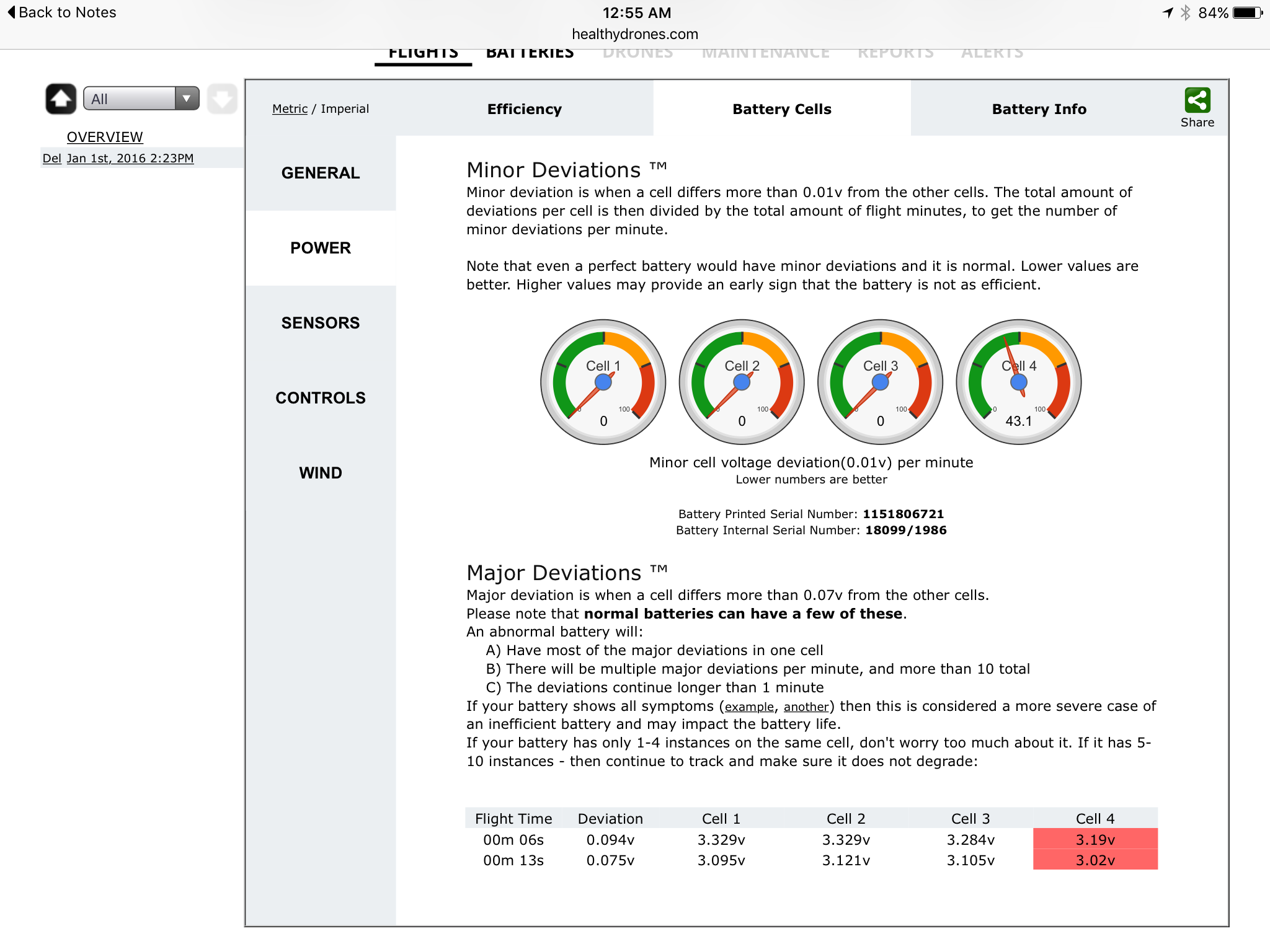

A. 87% upon launch, and it still read 85% after the crash, as the battery survived, and it's History Record 01 read, in red, "Critical battery protection" instead of "Normal", as the other History Records 02-20 read in black.
B. Yes, ascent straight up to 240 feet, under full throttle
C. Shutdown and crash just 16 seconds into the flight, and P3P slammed straight down into the concrete steps just 15 feet away from me, over the edge of the deck I had launched from. My only clue while looking at the iPad was the red No Signal and red transmitter LED, which caused me to look up to see the last 20 feet of the fall. Video recording ended at 22 seconds, and was recovered in a new P3P, and shows nothing unusual except the ascent to 240 feet, where it ends at the time the battery shut down.
D. Battery definitely sat unused for well over 12 days, which is why I was surprised that it still read 4 green LED's, and that it still read 87% remaining in the app with 4.07V on the lowest cell, obviously in error! However, I only planned a 2 minute test flight, so I naively assumed I was fine. Besides, DJI says fly with anything over 50%+ battery in their new intro screen!
E. As to the 70°F, the 20°C cautionary threshold is 68°F, which means the starting battery temperature was within a fudge factor of the 20°C. I don't know where the 20°C or less came from, but 2°F difference is certainly close enough that the starting temperature was undoubtedly a likely contributory factor.
I also have supporting screen shots of all the above, should you wish to see them. Let me know if there is anything else I can supply to help.

That's very interesting. Your 1.4 firmware issue is almost identical to the 1.5 firmware incidents that have been reported, less than full charge, discharge mode, and high battery stress (full throttle). What did DJI tell you when they saw your flight records? Did they help you financially in any way?
I agree. Clearly due to the combination of the exact same factors. I'm expecting DJI to repair or replace under warranty, but that hasn't been settled yet. Crash only occurred on New Year's Day, just as I was preparing for a multi-hour series of destination flights and charging up all my other batteries, and running a test flight while waiting. I already have an RMA# but intend upon getting a better commitment with a support manager first, from my irrefutable documentation, before sending the bird in, which won't do anything other than confirm what the rest of the electronic files have already established.
