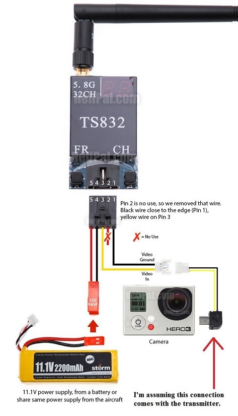

Here's a photo on how Heli-pal installs the FPV on the F550. that's how mine is...exactly.

No secondary camera. Right now there's only two "Video Outs" I can connect to. Either the video out on the Zenmuse H3-2D GCU, or the USB video out on the GoPro itself. As discussed earlier the video out from the GCU is a somewhat proprietary connection for DJI based equipment. So I guess the only other option is the USB out, just curious whether that connection is provided with the Boscam transmitter.
Now that I look again it doesn't appear so. The website states you get the following:
1. TS832 FPV 5.8Ghz Transmitter w/ Antenna
2. Transmitter Connection Cable
U.M.
UM, from the references I can find for that boscam Tx, it doesn't look like it comes with the cable setup like in your diagram...this is what I find in most pics:
This is an example of the cable you would need: http://www.hobbywow.com/en-gopro-av-cab ... 236905.htm
Don't let the cabling frustrate you too much or force you to buy a component you don't really want...I'll be happy to help whip up any custom connection you need for whatever you decide on ;)
