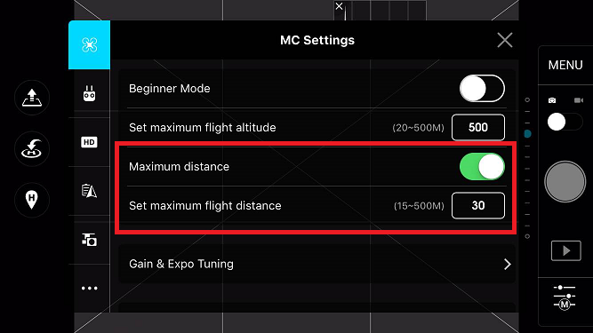

    Check that the following setting is disabled in the DJI GO app:

    Thanks for the tip msinger. I checked it and my GoApp screen looks a little different than yours. But Beginner Mode and Distance limit were both already switched off. Or could the GoApp somehow be running in the background while I'm using Litchi and then those settings come on automatically, then I have to go into GoApp to change them before flight?

    Was your Phantom connected to DJI GO when you checked?
  8. Gary M
    Jan 16, 2016
    465
    132
    No
  9. msinger
    Approved Vendor
    Oct 30, 2014
    27,862
    8,662
    Harrisburg, PA (US)
    It must be connected in order to view/change that setting.
  10. Gary M
    Jan 16, 2016
    465
    132
    Right you are! I just connected and re-checked and sure enough, distance limit was on. I switched it off, then powered down the drone, then powered down remote. Should that kill it?
  11. msinger
    Approved Vendor
    Oct 30, 2014
    27,862
    8,662
    Harrisburg, PA (US)
    I'm not sure what you mean by killing it.
    That setting will be updated on your Phantom as long as it's changed while your Phantom is connected to the DJI GO app. There are no additional power sequences that must be followed after changing the setting.
