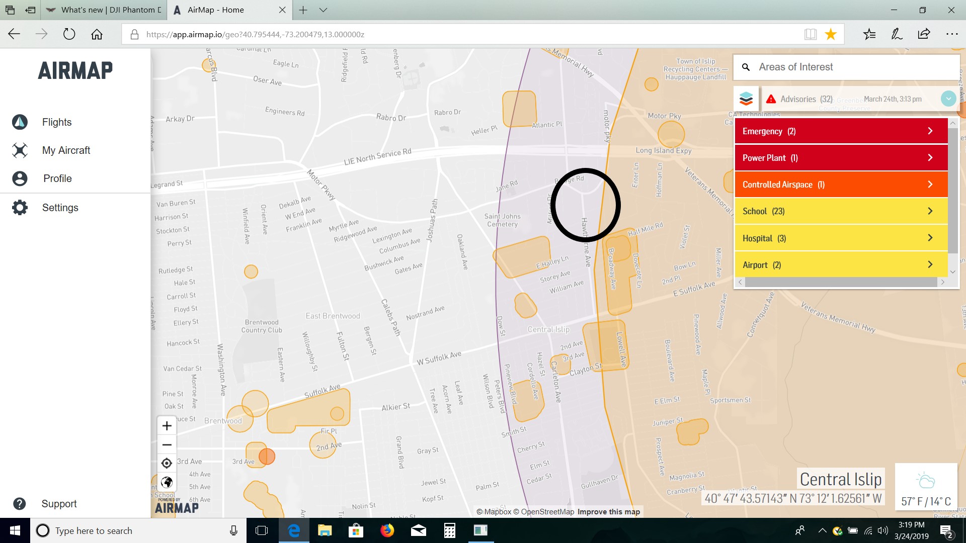

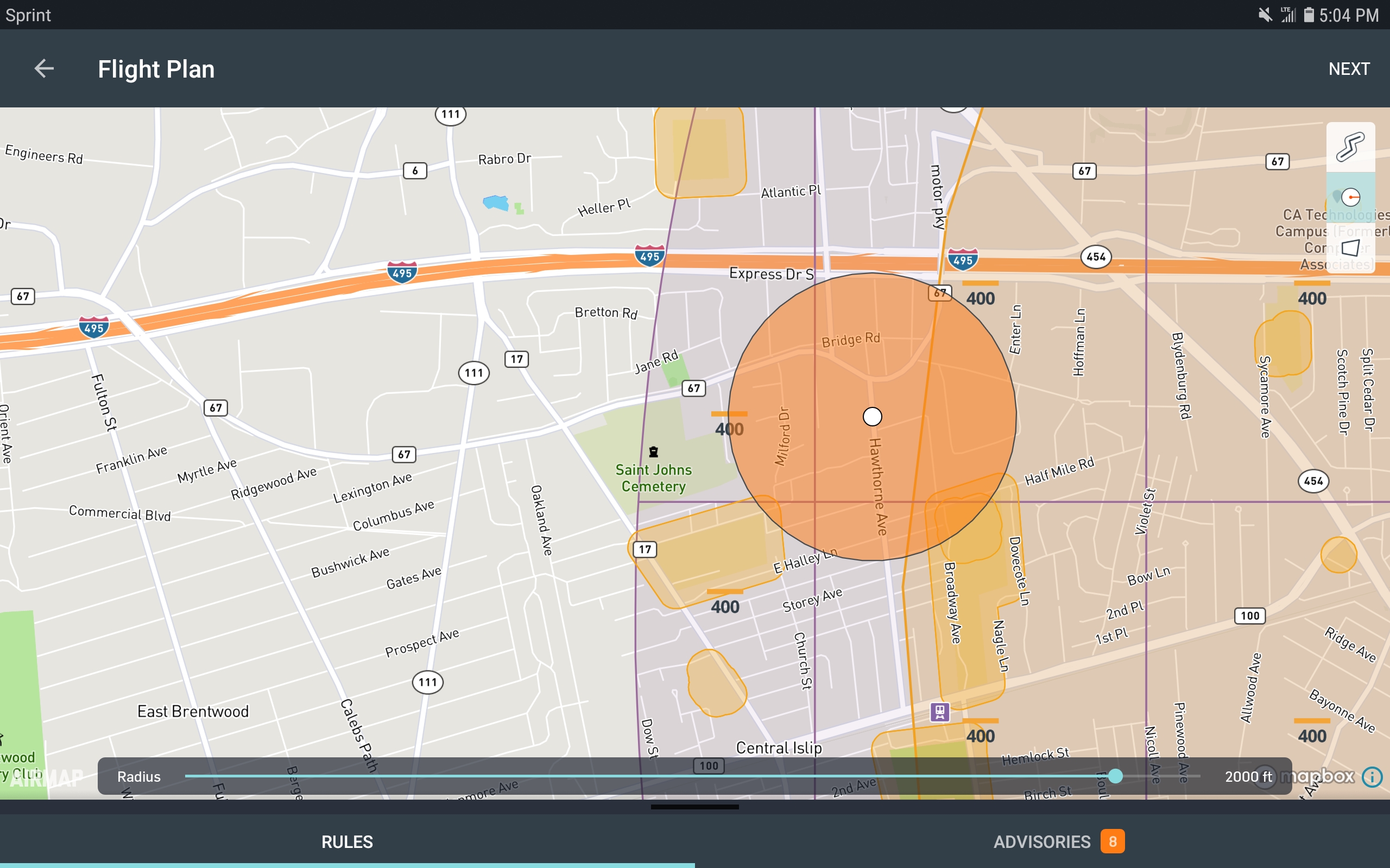

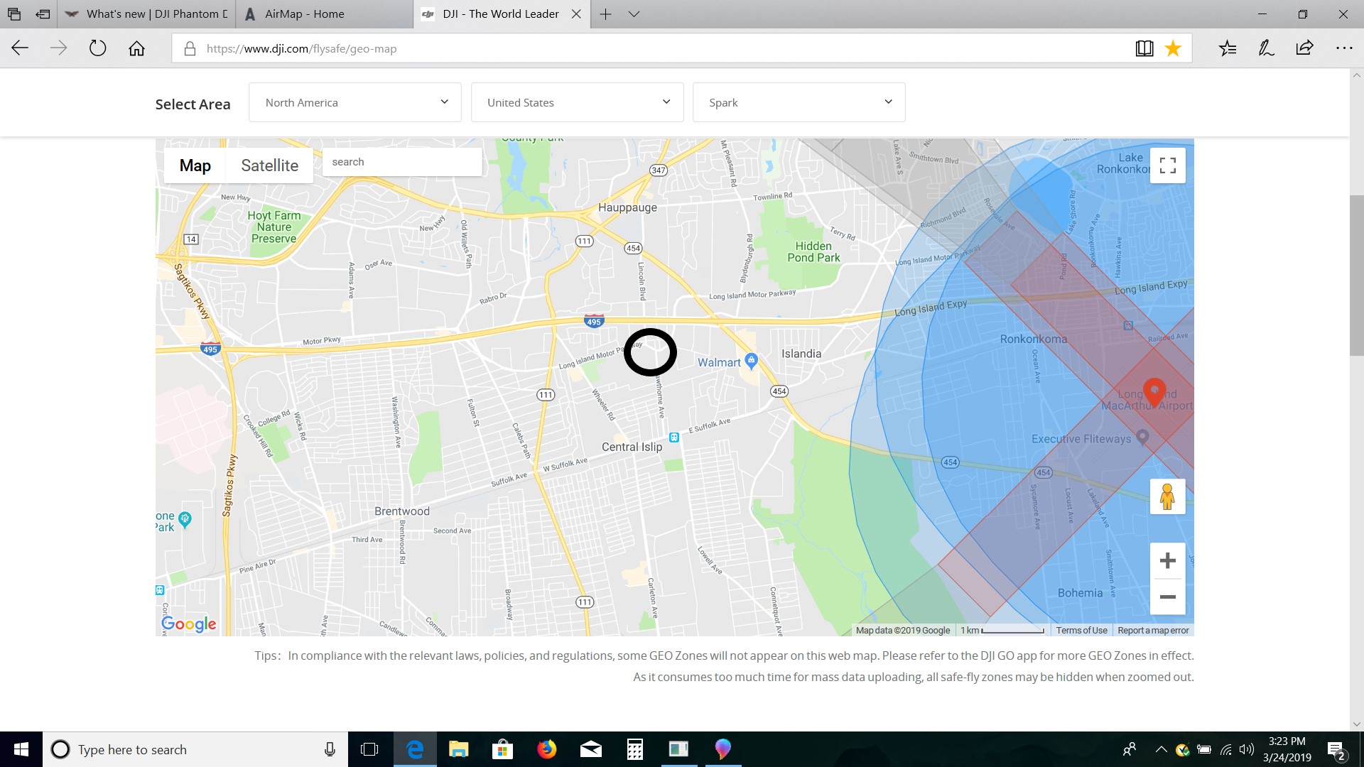

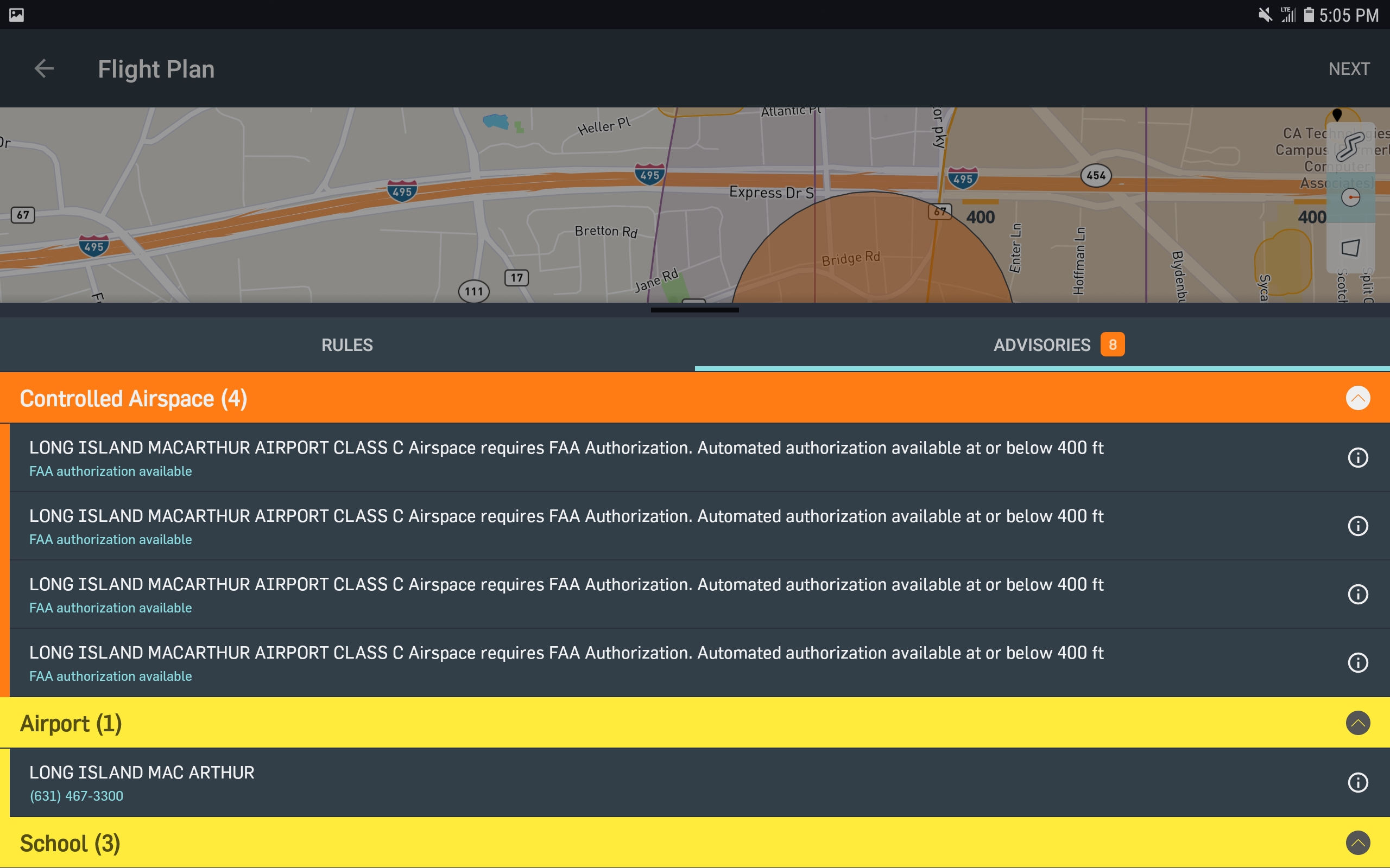

I'm not trying to hijack this thread but I had never used the DJI Geo-map website and wanted to see what it said about my area. The area circled is an area I'm planning to do some photograph so it was of particular interest to me. Unfortunately the DJI map conflicts with Airmap and knowing the area pretty well I'm sure the DJI map is incorrect. Airmap shows the location circled as being in the MacArthur Airport restricted area (within 5 miles of the airport) while the DJI map shows it's substantially outside the restricted area. It appears that if someone were relying on the DJI map (assuming the map is reflect the Geofencing no fly zone in the DJI app) they would be flying illegally inside the MacArthur Airport restricted area. Again, I'm not really familiar with the DJI map so maybe I'm interpreting it incorrectly.

What is the ceiling of that specific place? From what I see, you will not see a plane flying in that area, since they come in at 245° (aprox) and 315° (aprox). That spot is between them. You will be able go get authorization from LAANC, rather quickly.
The 5 mile restricted area around the class C airspace starts at the surface.
Just verified your flying area and I got prompted for authorization, so you can fly there up to 400'.
I am aware. This is why you ask for authorization to the LAANC. So you can fly within the 5 miles radius.
I understand that. My point was the DJI app does NOT show that area as restricted airspace.
That is because DJI's Geofencing isn't based on the FAA's circular system, but rather on Precission Hawk's Bow system. They will only cover the areas where height is restricted to below 400' and aircraft approach/depart paths.
Flight in that area is restricted down to the surface.
I disagree with you. It's a controlled airspace, not a restricted airspace.
The technical term (restricted or controlled) wasn't the point. The point was the DJI map doesn't indicate either. My understand was that the app would indicate areas where contact with ATC was required before flight, the so-called no fly zones. Is that not the case within this class C airspace?
Now I understand where you are coming from. Geofencing 2.0 is not a replacement for FAA authorization in controlled airspace. It's a way for DJI to cover their a.. due to the bad press stupid people did with their drones. When you see a news article about drones, 90% it's a Phantom model. The only app from DJI that is FAA approved for authorizations in the LAANC system is DJI Pilot (Enterprise models fly app), not DJI Go or Go 4.
In other words, if you wish to fly in an authorization or restricted zone, you need both LAANC and DJI's authorization codes.
But it would appear in this case that DJI doesn't recognize that area as an authorization zone. While I understand the DJI app is not a substitute for FAA authorization (I'm a private pilot, instrument rated with 107 pilot certification) those that rely on the accuracy of the DJI app, a reliance in part based on DJI restricting flight in certain airspace, would be misled into think that area circled is not an area where authorization is required. When DJI takes it upon themselves to restrict flight in certain areas (lockdown of a drone until they provide an authorzation code) they also take on a responsibility to do it accurately and consistently. When they assume authority to restrict flight in certain areas they should also be held accountable to do it with precision.
