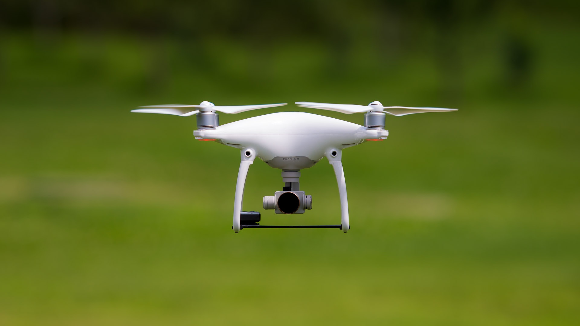

Word of advice. Mark ur phantom with your phone number! By a GPS tracking device to mount to It!
get a bracket like this for it but for a p4

Does the Trackimo have a magnetic attachment, will this interfere with the compass?
it comes with one you can put on but just set it to side and don't use it

I just ordered a Trackimo 3g for my Phantom 4. I am new to flying Drones.... can someone please recommend the best way and the best location to mount the Trackimo to my P4
Be careful mounting the trackers on any type of bar or gimbal guard under the P4. Gimbal guards have been shown to cause a yoyo affect and even have brought down P4's because they interfere with the sensors under the P4.
