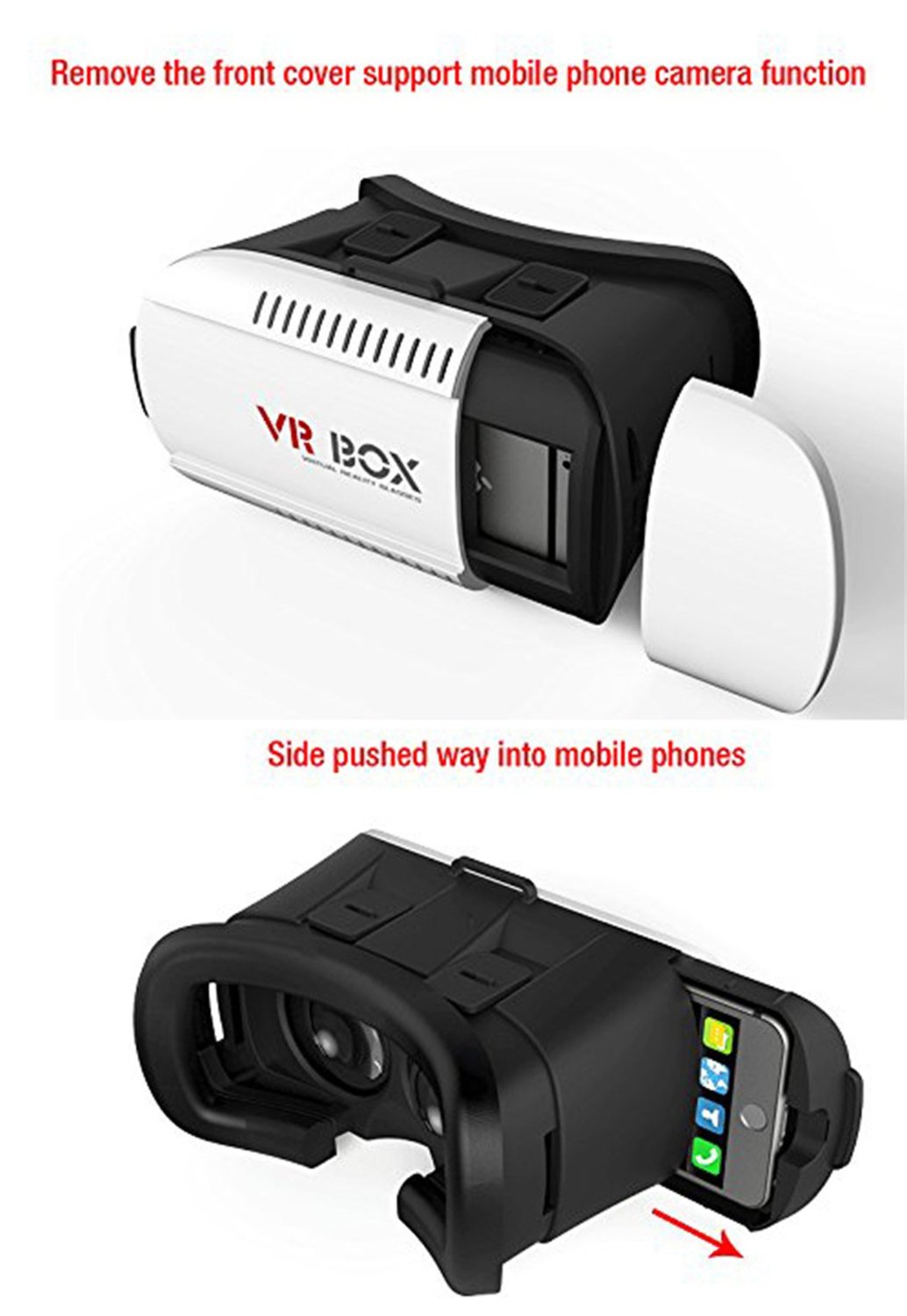

I wonder about a Google-cardboard or similar, like this: http://amzn.com/B0146DF02O
I would think it would work well and is very inexpensive. Anyone have experience with this, or similar?

Be aware that VR goggles crop the image you see versus what the Phantom camera sees. You lose about 50% of the image, it crops off about 25% on each side. This allows the image to fit in the 1080X960 half screen of the display (usually your phone is 1080X1920). This is because VR goggles split the screen and create two images, one for each eye. Most people don't like it after realizing how things are cropped to fit the display size. You will never see the exact image the camera is recording, which defeats the purpose of aerial photography.
If you're just flying for fun, then VR goggles are definitely a fun option, especially using the software that allows you to control the drone with your head movements. However that's not something that interests me, given the investment in the air. I'd rather control the drone with my hands and see 100% what the camera sees.

VR Box can't be used straight away as it looks for split images. If you want to use VR Box or Google Cardboard, you may need to use apps like Litchi or Fpv Camera.
Also you need to use USB port of RC, that means DJI go app will not be available when you are using that port for Fpv goggle.
I use goggle on HDMI port and DJI app on USB simultaneously and get best of both.
