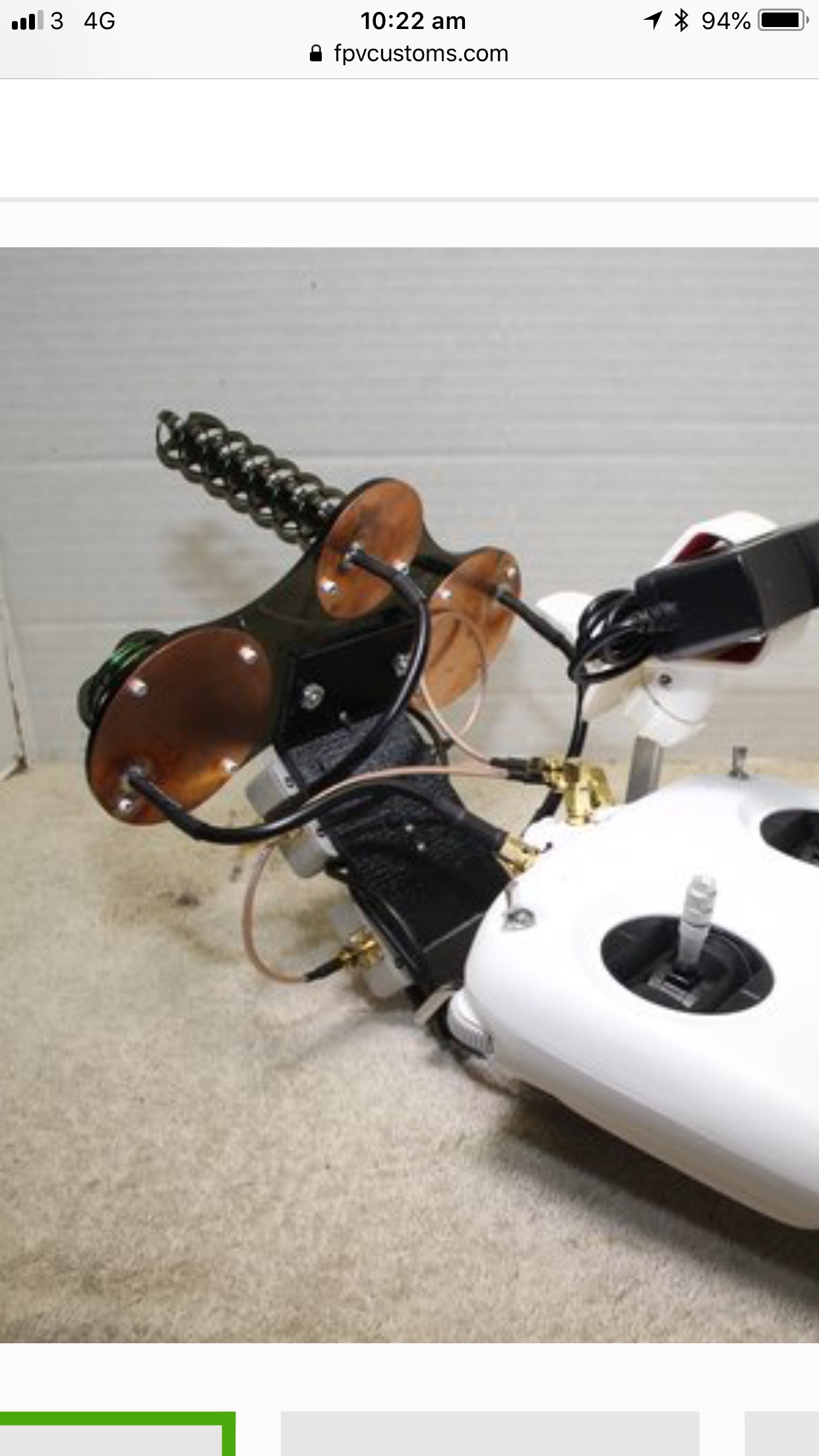

So if I’m looking at putting boosters on my controller then it needs too be x3 two 2.5ghz and one 5ghz one ?
but look at this modded controller I found on the internet the 2.5gbz one on the left is not being boosted only the other two are

Man......some of that added antenna hardware....sure adds quite a bit of forward weight.......id take that in consideration IF i was going to add that type of antenna
then you have added battery's to recharge !

So if I’m looking at putting boosters on my controller then it needs too be x3 two 2.5ghz and one 5ghz one ? View attachment 97967 but look at this modded controller I found on the internet the 2.5gbz one on the left is not being boosted only the other two are
You don't have to use two boosters. The receiver with the stronger signal would be the one used. Two would be better, but not necessary.

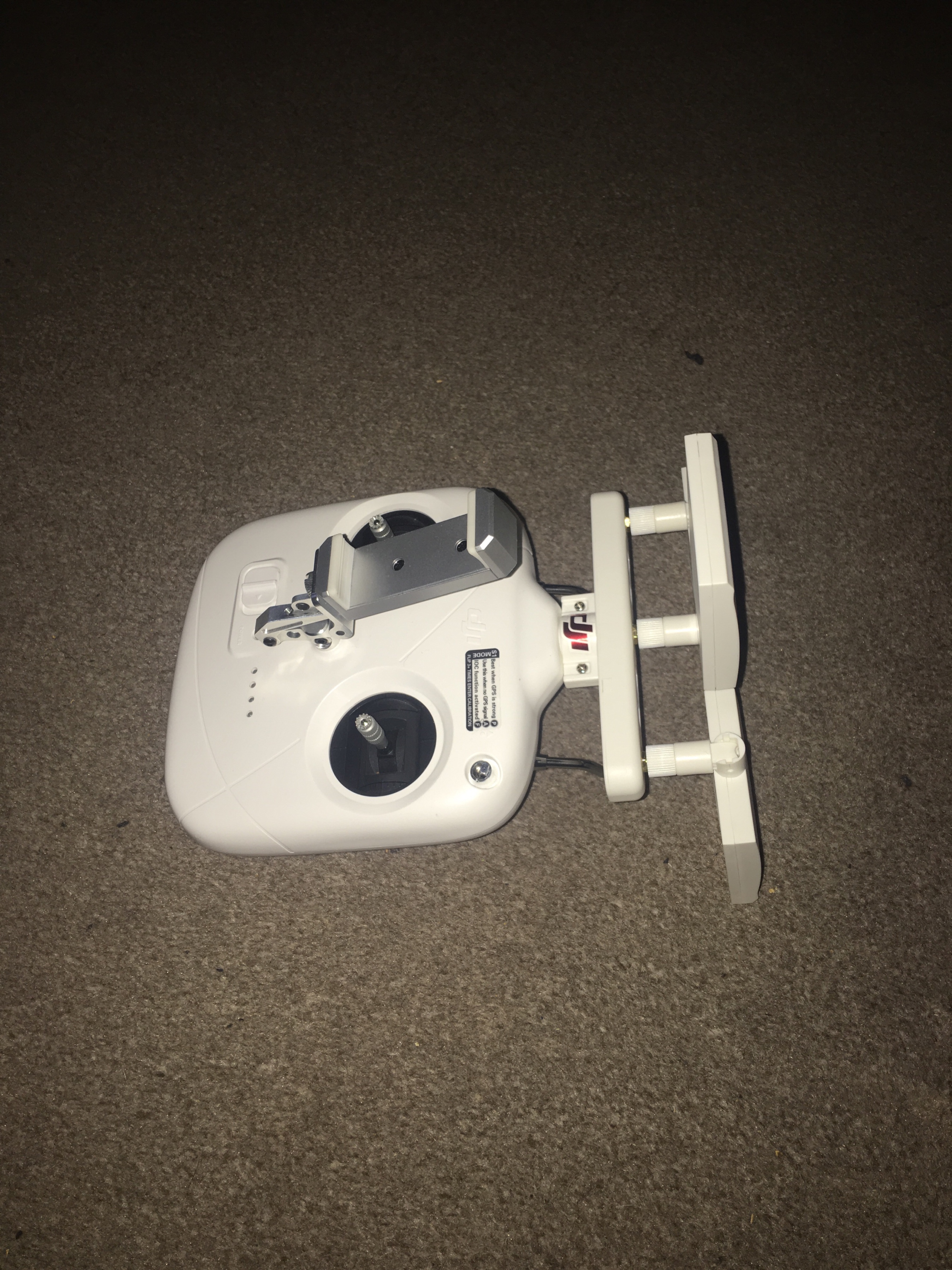

I’m thinking of giving these ago I think they should work right
I’m not trying to break any distance world records but just don’t won’t to keep getting video lost feeds then drone lost
Jul 6, 2016
111
17
43
What drone is that I’m curious? If it was mine I would hook up all three I’m sure it would help the range like no other!
Mar 4, 2018
110
22
37
A 5volt power bank with 3 line outs and it’s a phantom 3 standard
So going to put them on and see what we get
