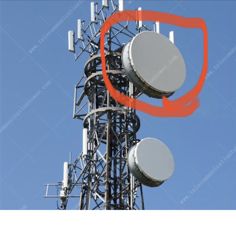

2. If you see a white cylindrical device, do not fly in front of it - it's a long-range microwave transmitter which uses narrow beam but with large power. Large enough to actually fry your receiver, if the load is heavy enough.
Can you show a photo of one of these?? thx
Still don’t know which part of that is the “white cylindrical device” you mean.
Do you mean this part?
Yes ... those are directional microwave antennas, aimed at a similar antenna miles away on another tower.
The vertical antennas are for cell phone service.
So to resume. If you fly near the tower don't fly directly in front of that.
Any idea what kind of distance you’d have to be from one of these without a problem?
50’? 100’? 400…?
Presumably if they’re designed to send a signal several miles away we could be flying through that beam of transmission a mile away and never realize it.
Living in Chicago area there must be hundreds of microwave towers. I am sure I’ve flown through their transmission range near and far hundreds of times.
Although most of them probably don’t have those concentrated long range devices on them.
Now I’m going to keep my eye out for them.
