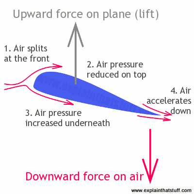

I find this amazing science. The air molecules get stretched on top of the wing, effectively sucking the aircraft up. (2)
But this is the real amazing thing, because of this lift concept a body with an aerofoil shape can go faster than the wind behind it. It takes me ages to explain this to students, they just don't believe me at first.
I asked a guy called Joe on a land sailer this question two weeks ago and his reply was "Sh** yeh, more than twice the speed" I don't know the actual speed ratio it can be, but it's obvious on airborne, landborn and seaborn. Those sailboats way exceed the speed of the wind behind them. It defies logic in a way but so true.
Put your hand out of the car window, point your fingers directly towards the direction of the car then lift the tips of your fingers up and your hand will rise that is the air pressure underneath. (3)
I would tend to disagree on this point from a very precise technical point of view. The molecules themselves are not "stretched". They are molecules and remain the same size. What happens is that the air density decreases above the wing. There are less molecules per cubic meter above the wing than there are below the wing.
