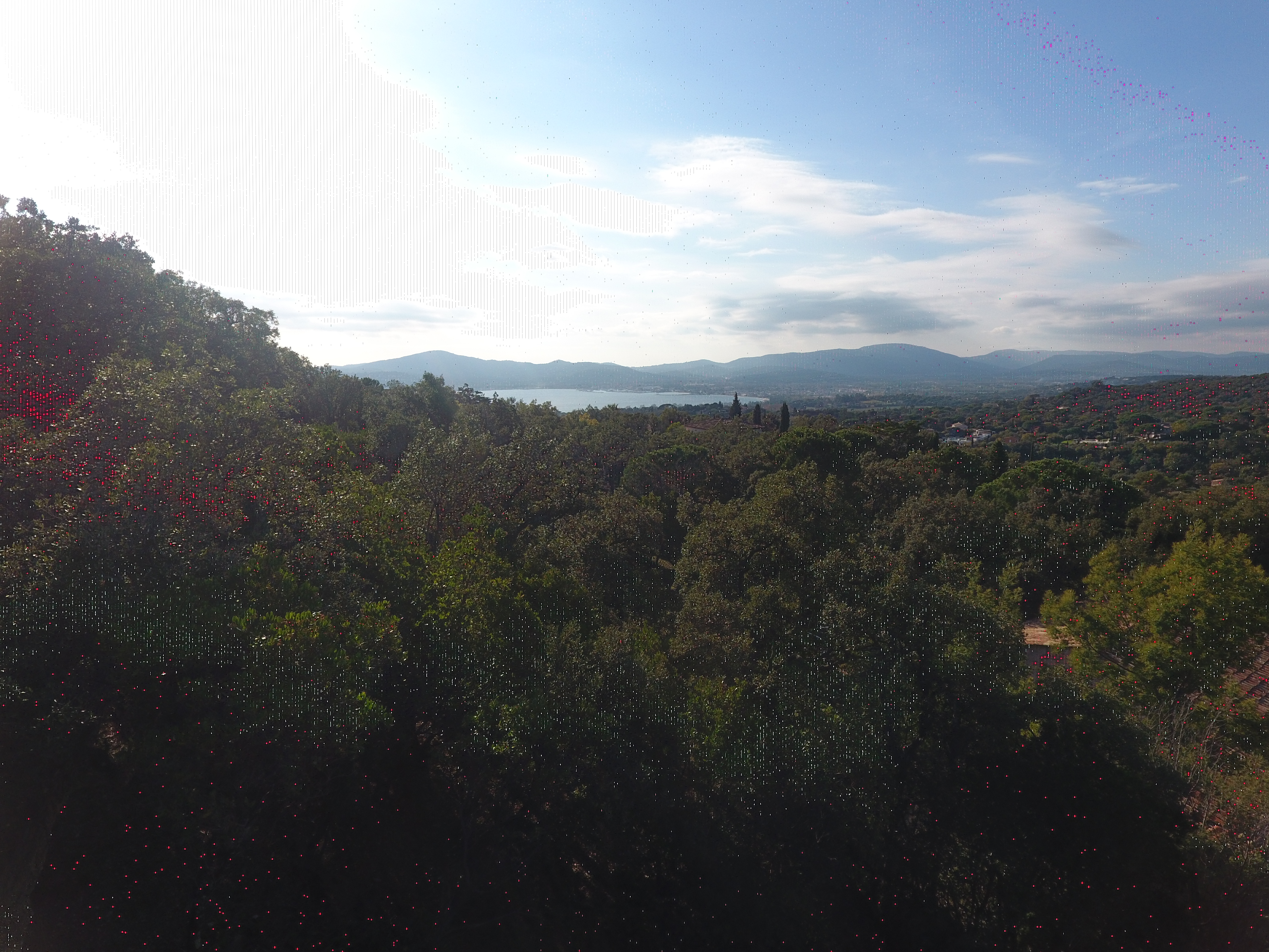

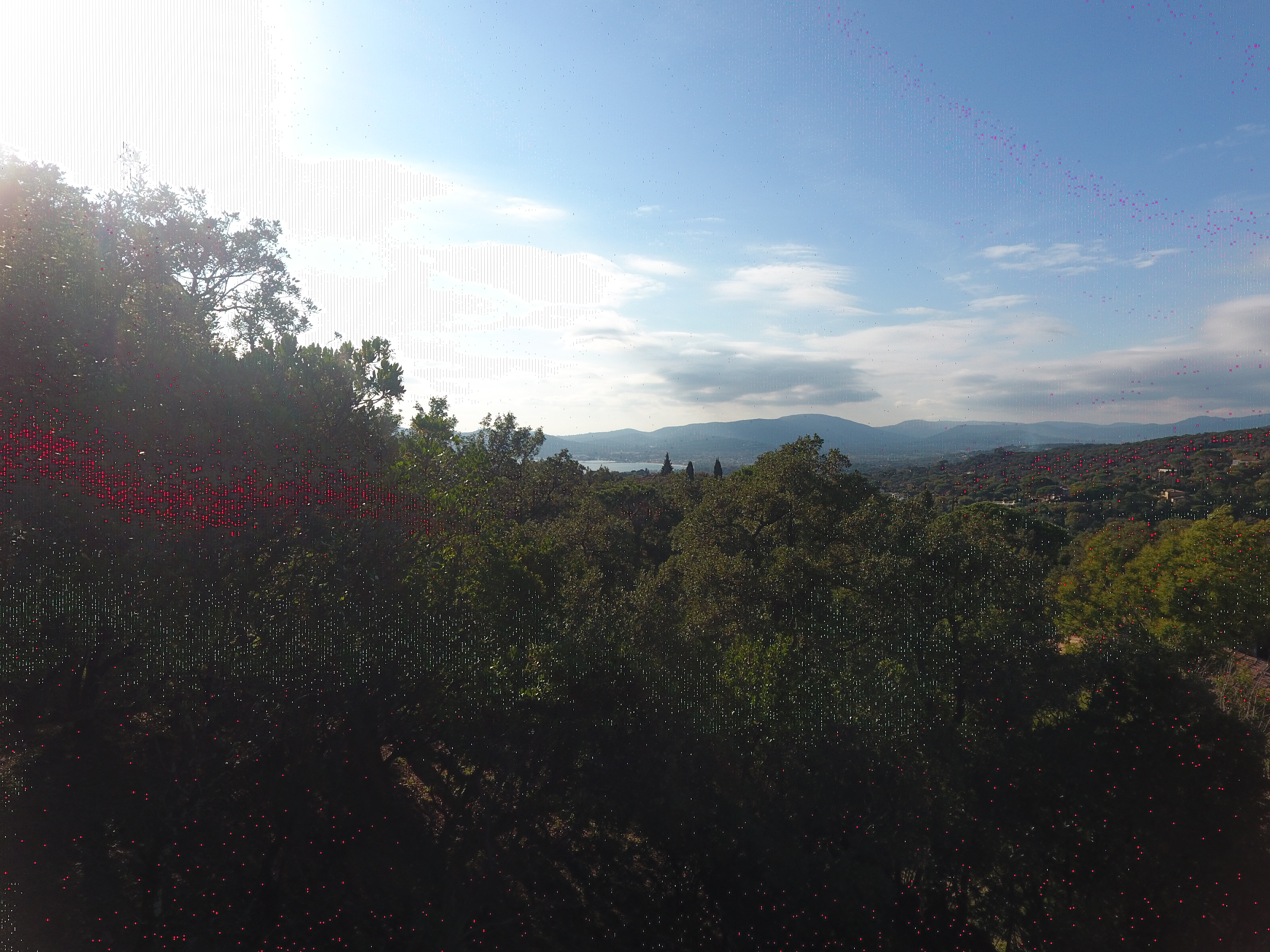

Hello,
I have the same issue as @HBa.
Same thing happening with red, white and black vertical "pixels" appearing on my phone and on the recorded file on the SD card. Many appear at times and few on other occasions (depending on the exposure I think) wether on film or photo mode.
I've had my P4 for years now and it never crashed or had a bug before.
I flew it on different occasions this summer without any issue.
I had to update it last week and flew it yesterday when the issue appeared, have to say it is really annoying.
Could this be related to the software update ?
It seems that this issue appeared last september on various forums, I didn't do extensive research on it but it would be great to find a solution.
Hello,
View attachment 120807View attachment 120808
you need to replace the flex cable
