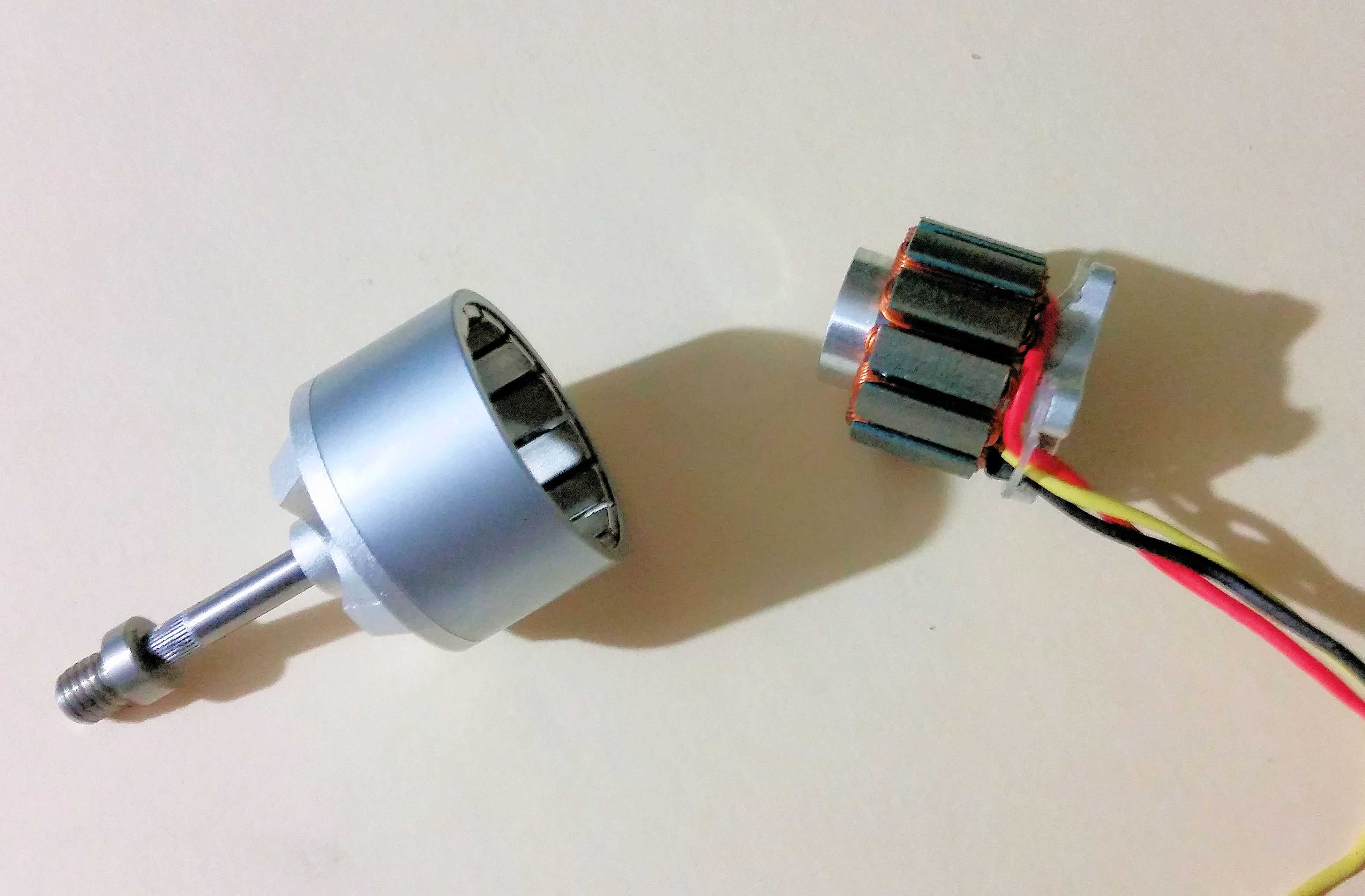

From everything I read, 2312A motors require a press to be opened, as you basically have to push the shaft out of the bell, as in the photo below
[EDIT: the photo is actually of a 2312, not 2312A, thanks to @epicdoom for pointing that out]:
Anyways, I absolutely agree with you: if you can/want to open the motor, that's of course a possibility. Put good quality bearings in it and it will probably last forever.
From everything I read, 2312A motors require a press to be opened, as you basically have to push the shaft out of the bell, as in the photo below:
that was on the 2312 old motor the new 2312A doesn't have the shaft the prop screws direct into the threads cut into the top bell
My bad, you're right, that was an old 2312. But the comment about 2312A being difficult to open is still valid, plenty of posts about that.
