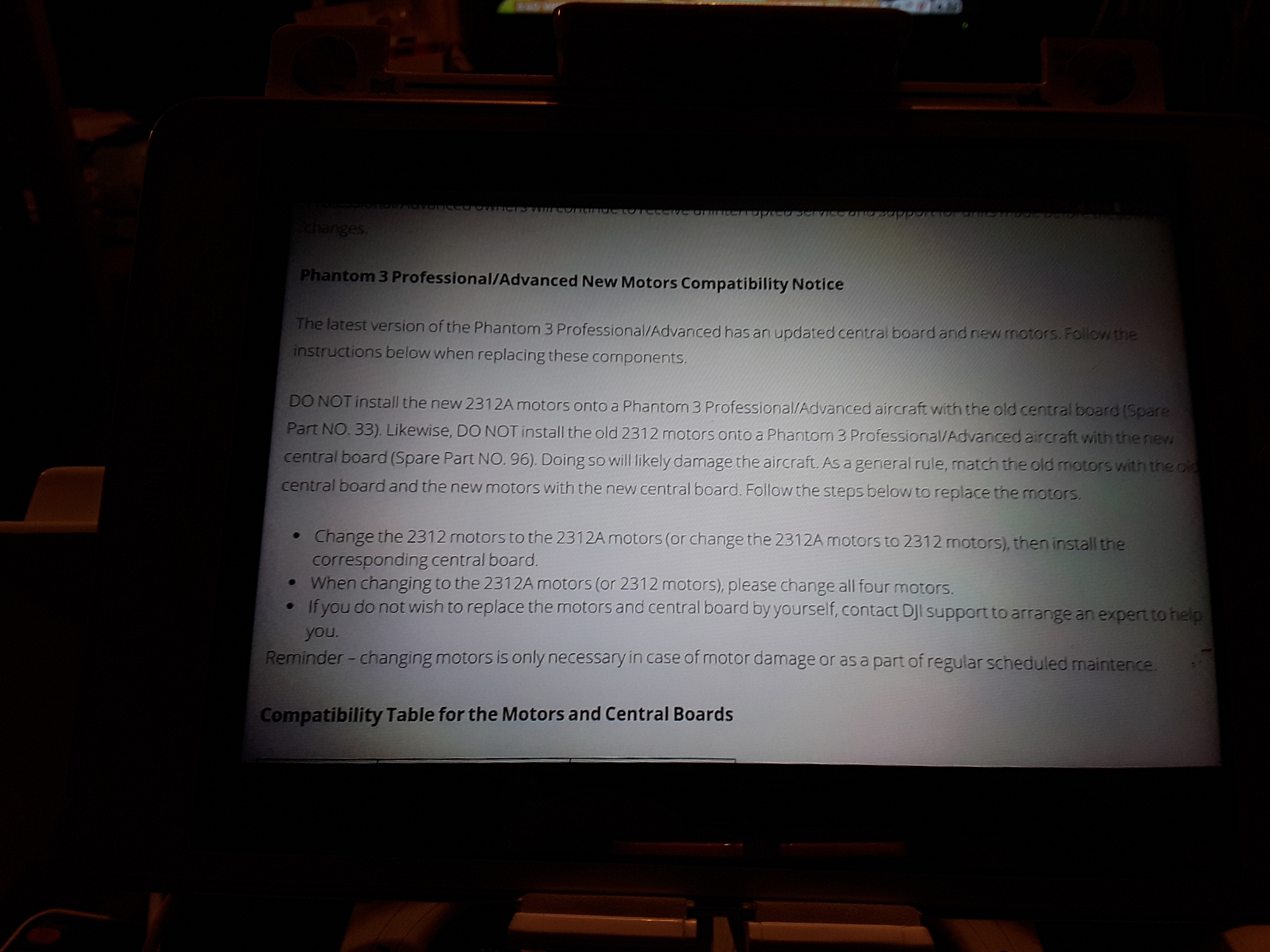

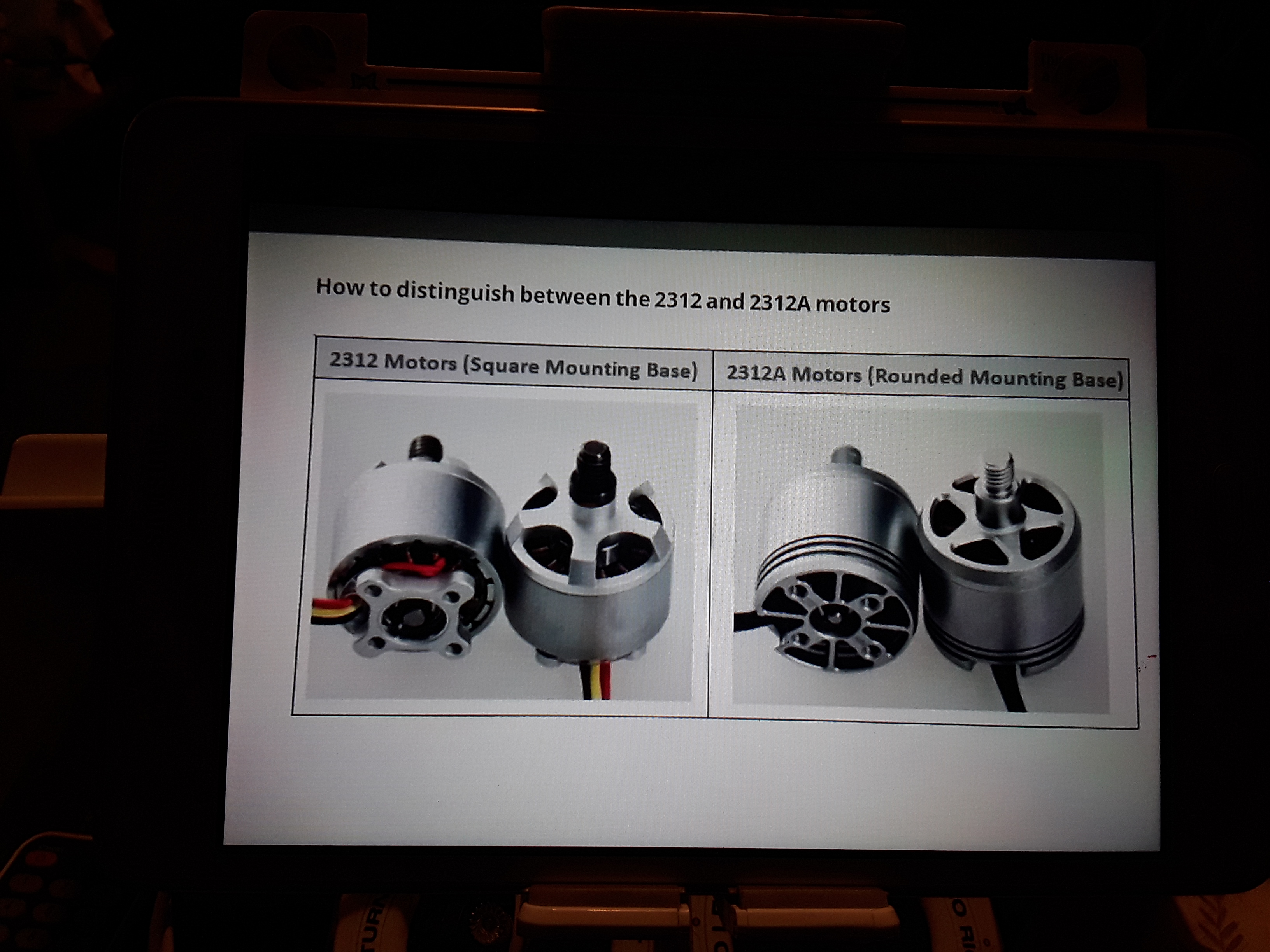

View attachment 88214 View attachment 88215 hi yip good price for motor,i do hope you motor works seems there a few motors around that can damage your board,like above post say some are not compatible even though they look same,have a check of mounting screws at base ,couple of sorts
As long as you get the right motor model # correct, there is zero issues. The original 2312 will fry a 2312A board. So, just get a 2312A and no worries. ;)
