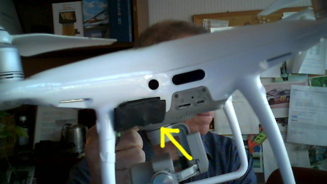

I have mine mounted behind the left front leg with Velco. The antenna runs down the leg. According to a discussion with the manufacturer, the best antenna reception will be from a vertical orientation, and the worst from a horizontal one if lost. Leading the antenna down the leg will at best wind up vertical (if it lands right-side up or upside down) and at worst at a 45 degree angle if leaning on two of it's prop arms. It could wind up horizontal if hung up in a tree, but I'm playing the better odds by running the antenna down a leg.
I have mine mounted behind the left front leg with Velco. The antenna runs down the leg. According to a discussion with the manufacturer, the best antenna reception will be from a vertical orientation, and the worst from a horizontal one if lost. Leading the antenna down the leg will at best wind up vertical (if it lands right-side up or upside down) and at worst at a 45 degree angle if leaning on two of it's prop arms. It could wind up horizontal if hung up in a tree, but I'm playing the better odds by running the antenna down a leg.View attachment 104800
MM53, kudos for the reply. Being an engineer I like when folks dig deep to arrive at great answers. This is a great idea. I hope Watsojw also takes a look at this idea. Makes good sense on the orientation of the tag. Thanks for sharing this idea. Great forum, great folks. Most appreciated.
