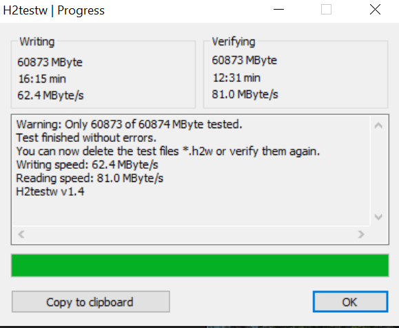

Yes I format the cards in the drone, I have tried so many things already, starting to lose hope.
Here is a picture of the results:

Bought the cards at best buy, they are all genuine. Look at the attached pic in the last post for the write speed, more than enough. Something in the drone is getting overloaded with too much data flow I think
Those read/write numbers certainly look OK - always worth using a full h2testw on a new card no matter where it came from (even cards bought from Amazon have been fake).

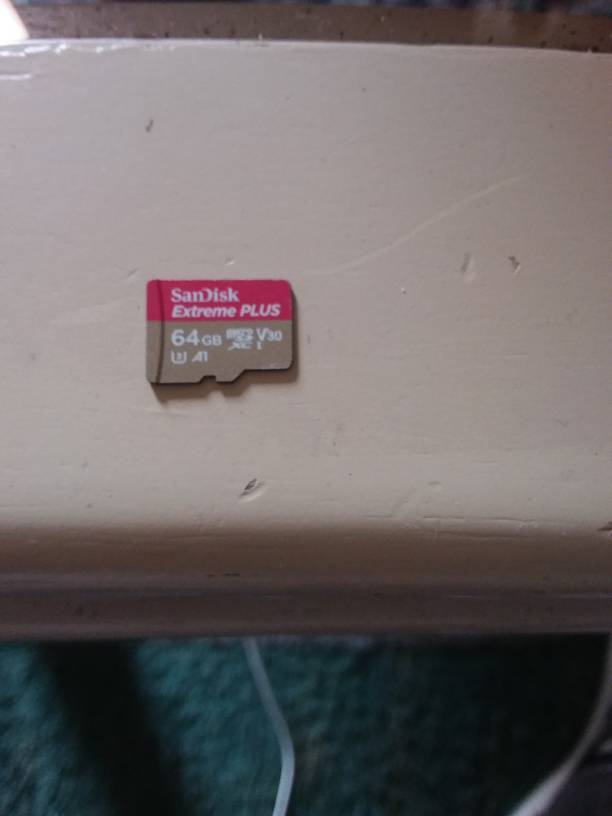

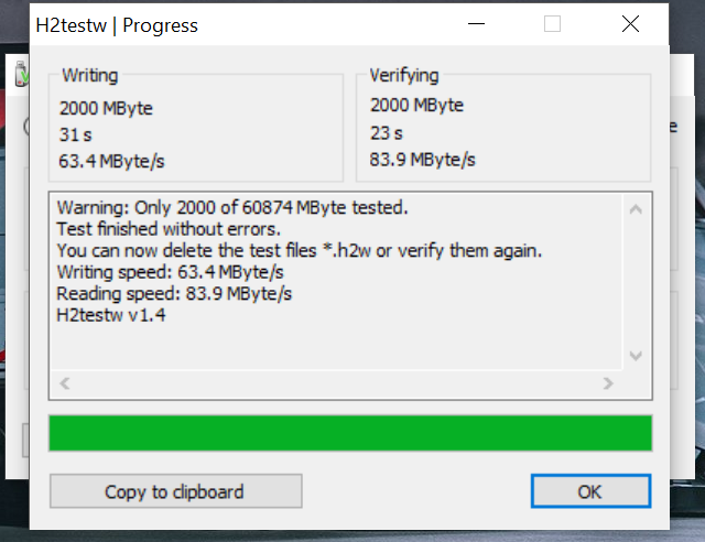

Bad news i ran out and snagged a SanDisk Extreme Plus, test reported 90MB/s write 95MB/s read, surely this is enough for AT LEAST 1080p/30fps. Well turns out, NOPE. drone still hates me, doesnt even want to record 720p anymore :mad:
