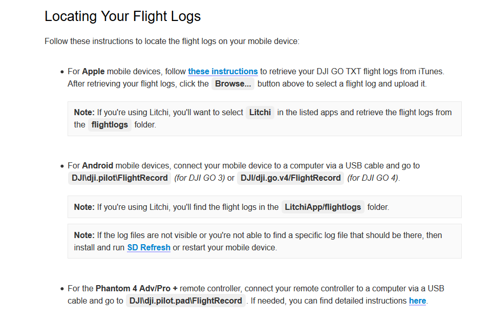

As Meta4 said above and I as well, follow the Phantom Help link that is posted above which is the same one I previously mentioned. Below is a short screen snip of the instructions located there as I mentioned to you previously.
