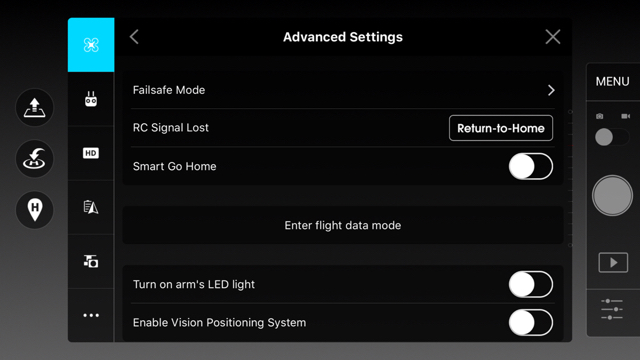

    It was under Advance Settings in an older version 2.4.3 of DJI GO.
    Now under Advance Settings in DJI GO version 2.5.0 I can't seem to find it anywhere.

    ImageUploadedByPhantomPilots - DJI Phantom Forum1452625300.528975.jpg same place ...

    That is exactly what I was expecting. Here is a very bad picture of what I am getting. Hopefully you can see the bottom lines are not on the screen
    Here is a link to where it is stored:
    DJIGO | DJI Phantom Forum
    Any idea what to do next?
    GR

    Palastiroland, it's in the "Main Controller Settings" --> "Advanced Settings" section of DJI GO.
  13. Palastiroland
    Jul 26, 2016
    6
    But in my case it isn't there. xD
    So what can i do?

    Which Phantom do you own?
  15. Palastiroland
    Jul 26, 2016
    6
    I've got a Phantom 3 Standard :)
  16. msinger
    Approved Vendor
    Oct 30, 2014
    25,595
    7,757
    Harrisburg, PA (US)
    The P3S does not have VPS.
  17. Palastiroland
    Jul 26, 2016
    6
    Seriously xD ok then my fault.
    Thank you for the help mate.
