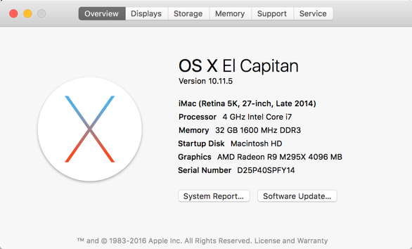

I also have a maxed out IMac 5K Retina. I get very juttery video playback.

You get jittery playback in editing software or in player?
If it's jittery playback in software, perhaps the problem is in a graphics card with only 4GB of VRAM that drive that display and help drive the performance of editing software. This machine seems more focused on wowing the production world with a "5k screen" instead of putting more horsepower behind that screen which would make it even more useful.
You're pretty much stuck using FCP on this machine. Premiere is a completely different animal with or without the Mercury engine, which means you need Nvidia graphic card. So "software-only" Premiere is going to crumble dealing with AMD.

I get Jittery playback in Quick Time and in FCPX and Premiere. I believe you are 100% correct about the graphics card. I bought this 5K iMac thinking it would be a 4K monster. It is not, not even close. $4,000 worth of junk. I can't even get it to work in Target monitor mode to use with another computer. Thanks for the reply.

Hmmmm...you get jittery playback anyway? Maybe problem is in HDD.... Is it near full? OS needs to be at least 10% free, add some buffer for other stuff....
It's a 1TB SSD that is only half full. It is also much faster than any of my external drives.
Ok. "Smells" like AMD issue after all. I'm in the PC world , but I would like to help if I can ...
Lets try something...iOS likes ProRes codecs.
When you play video, your computer needs to de-compress every frame in realtime so you can see the full quality playing. That is done by the GPU. When you work with an edit-friendly full-frame codec such as ProRes 422, the GPU does not need to work hard to decompress the video frames on the fly. But when you work natively with very compressed and high pixelcount XAVC, AVCHD or H.264 video, the GPU will have to work much harder.
If you optimize footage to ProRes before editing, I belive you won't have any issues...

Thank you for your help. I will give your idea a try and report back with my results. Although I believe I have tried what you are suggesting and I still got a few what seems like dropped frames. This has been going on for more than a year now and I'm very frustrated.

@MichaelS I have a MacBook Pro with about half the processor (quad [email protected]) and 16GB of RAM and it plays back and edits 4k video flawlessly in QT, FCPX or imovie. I use an external Thunderbolt SSD. Have you benchmarked your drives? Here's a decent app for that:
Blackmagic Disk Speed Test on the Mac App Store
It's not normal by any means for a 5k imac to judder on 4K playback.

I also have a fully loaded MacBook Pro 15" Retina that works flawlessly. I think I might take my iMac to my local store and see if i can get some answers.
