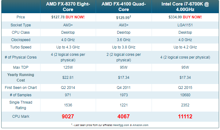

You virtually doubled your performance, going from 2 cores to 4 cores, along with a 10% clock boost. Glad that all worked out. Below is how the two compare for general performance. Notice the power consumption went up about 30% with the AMD 4 core CPU. AMD has really good graphics technology (not as relevant here since you are using the GPU), but they consume more power than Intel processor of the same performance. Look at the age of your original (2011) versus the 4 core unit (2014). You can compare any processor for general performance here, using Passmark. I find this very handy to pass judgment on various CPU's. Below shows 2015 vintage Intel CPU of equivalent clock rate with 4 core having 20% more performance, with lower power, but at double the price. BTW, the pricing in the Passmark website isn't relevant to today's price for FX8370.
Thanks for your input John. I use Sony Movie Studio to edit videos. I am pretty sure somewhere in those settings I could select/unselect the GPU to render videos and I unselected it. Your thoughts about that? I guess my point was, I was able, (luckily), to salvage a PC that was about to go in the trash to a machine that could easily perform the job I needed it to for only $200.
