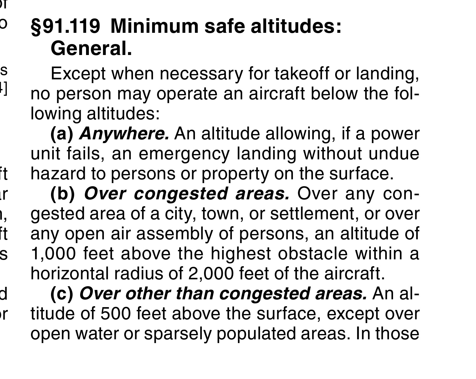

FAR 91.119 (b) states the no person my fly an aircraft lower than 1000 ft above the highest obstacle within a horizontal radius of 2000 ft from aircraft.
So if everyone is following the rules correctly the aircraft and sUAS will have a vertical separation of at least 600 ft.
Keep in mind both manned aircraft and sUAS pilots have to follow see and avoid rules.
