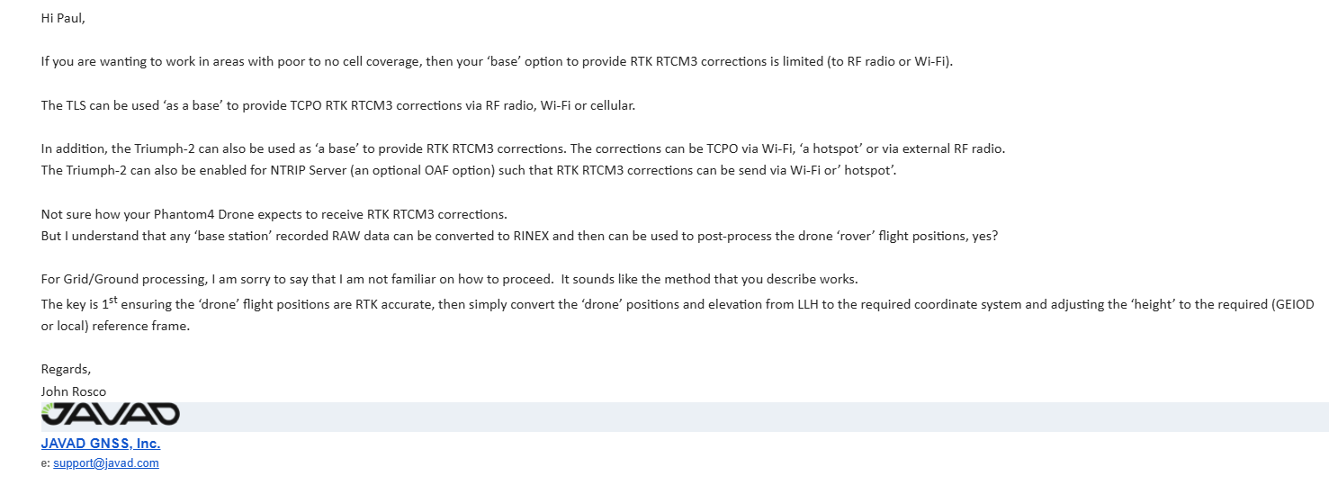

Thanks for the welcome and thank you again for addressing my questions, please see the attached about the Javad unit. I'm researching and working on the best possible solution.
Thank you again!
Paul
