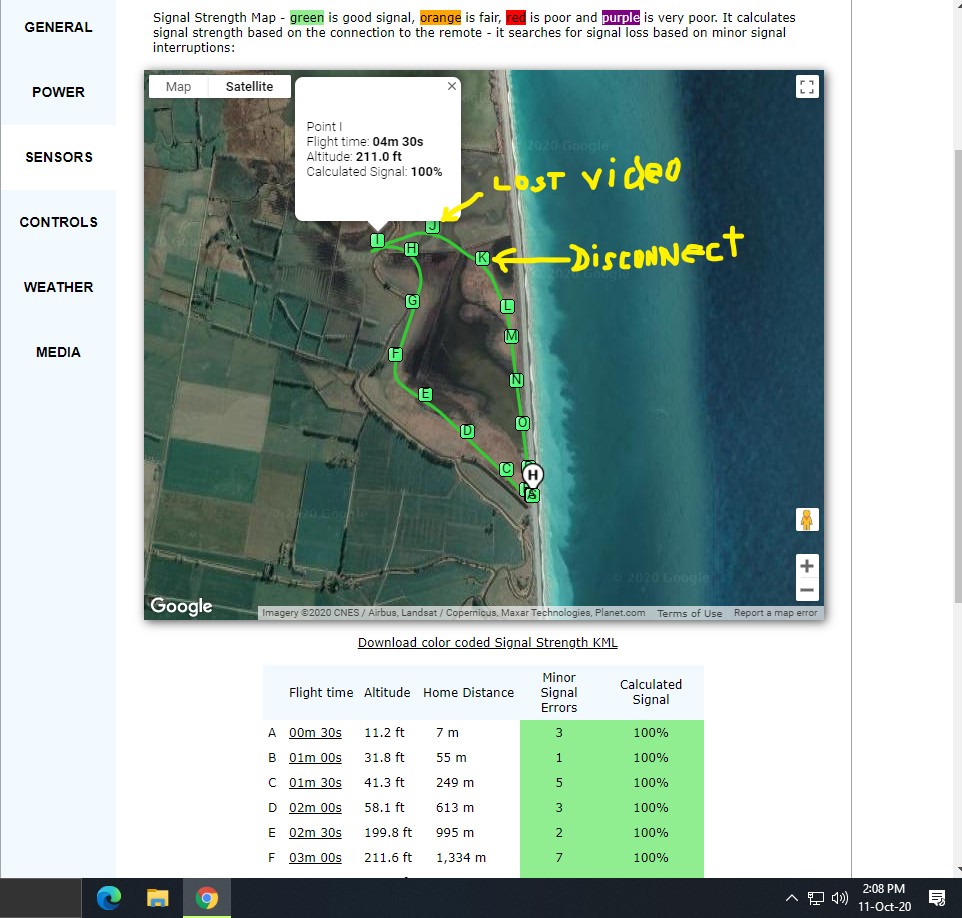

Good morning everyone, yesterday I had a interesting return to home where I lost video signal but still had telemetery and map so I followed map to guide myself home untill total disconnect. Hit RTH and drone starts to make her way back...never recovered video through the whole scenario and also no recording on sd card from the moment of total disconnect like the camera or recording had totally shut down.Just wondered if others had ever experienced the same as me.

Works fine after rebooting the controller and drone, I took it out for another flight immediately and no problems. The funny thing is that I uploaded my logs to Airdata and it shows no disconnect and 100% signal throughout the entire flight it records the RTH but no dropout signal evidence in the log at all and yet it clearly said on my tablet that it had disconnected ...damned if I know!

Fiirst I lost video and flew back to a point where it disconnected just using the map (my Ipad stated signal disconnected) , immediately I hit return to home the controller started beeping as it does on RTH and I could see on the map it was coming back but Video never recovered all the way back to the home point...hope this clears it up

Yes its fine, I went out and flew 5km today & no problems whatsoever thanks. This flight and disconnect had me baffled because as I stated in a previous post when I uploaded my flight logs it shows no disconnect and 100% signal for the entire flight, yet my Ipad clearly said "disconnected" and I lost everything momentarily until RTH initiated then the map & telemetry came back.
