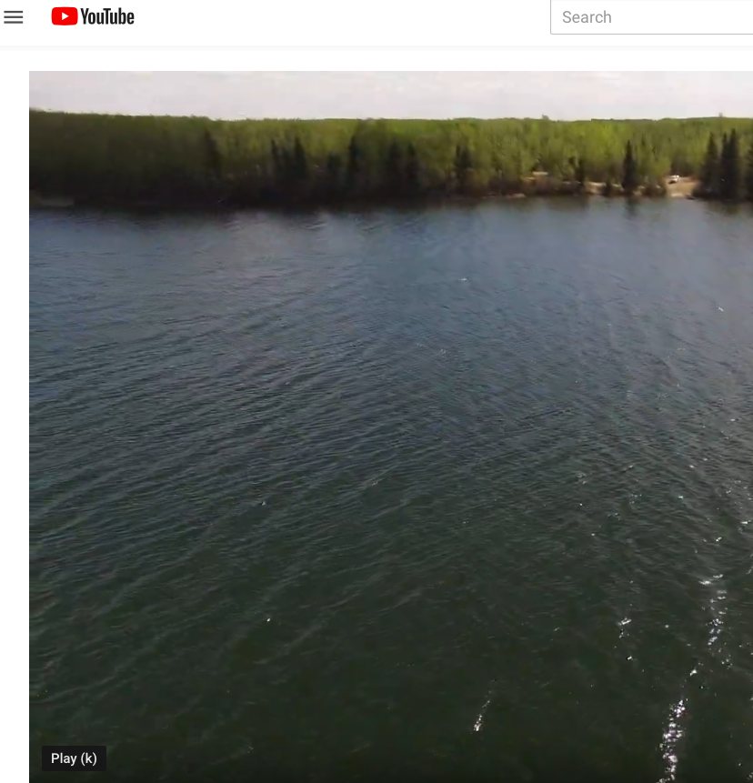

Some of the video looks great but take a look at this picture from your Hanmore lake vid: You can really see what you are trying to get us to see on this other video but is much clearer in your other videos.
I think the phantom drone and camera are working fine as some of the video looks really good.

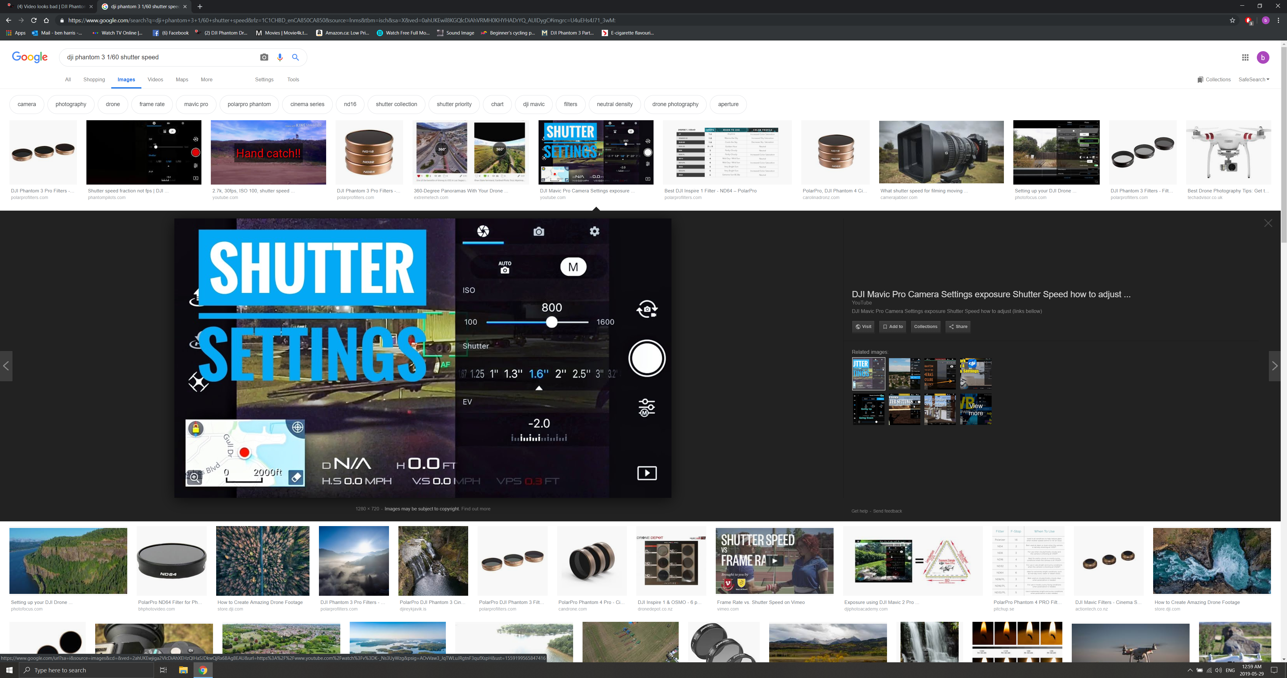

I want to manual shutter speed and i can't see where it says 1/60 i see 160
is the number in the redbox the shutter speed or are the numbers above it the shutter speed
not sure how to set it to 1/60

Is this the right setting in the dji go app for 1/60 sec shutter speed

does this look better
No that number in the red box is not Shutter speed. The control under the blue “Shutter” is the shutter speed control. They leave off the “1/“ for brevity. This is done on SLRs too. The makers assume you know that shutter speed below 1 second is in fractions of a second.
