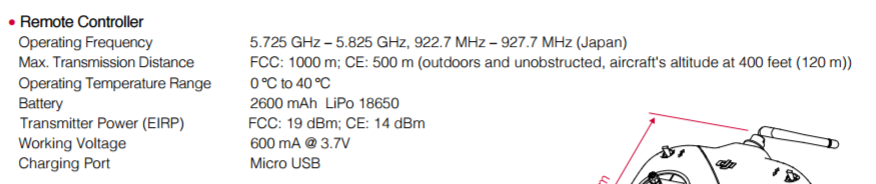

Didn't know that buddy.
19dbm vs. 14dbm.
Magic power has nothing to do with the 5.8ghz.
Power Magic change area too...
If you are in CE area you can setup FCC area. So it changes 5.8ghz tooo to FCC.
It does a difference , i live in france and notice better results on 5.8ghz after applying power magic.
You ll have no change on 5.8ghz only if you live in USA...
