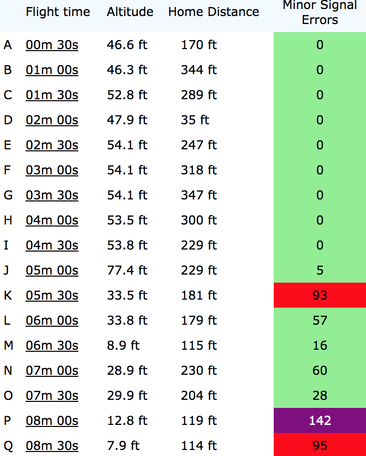

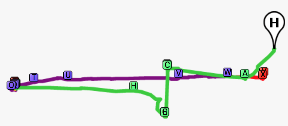

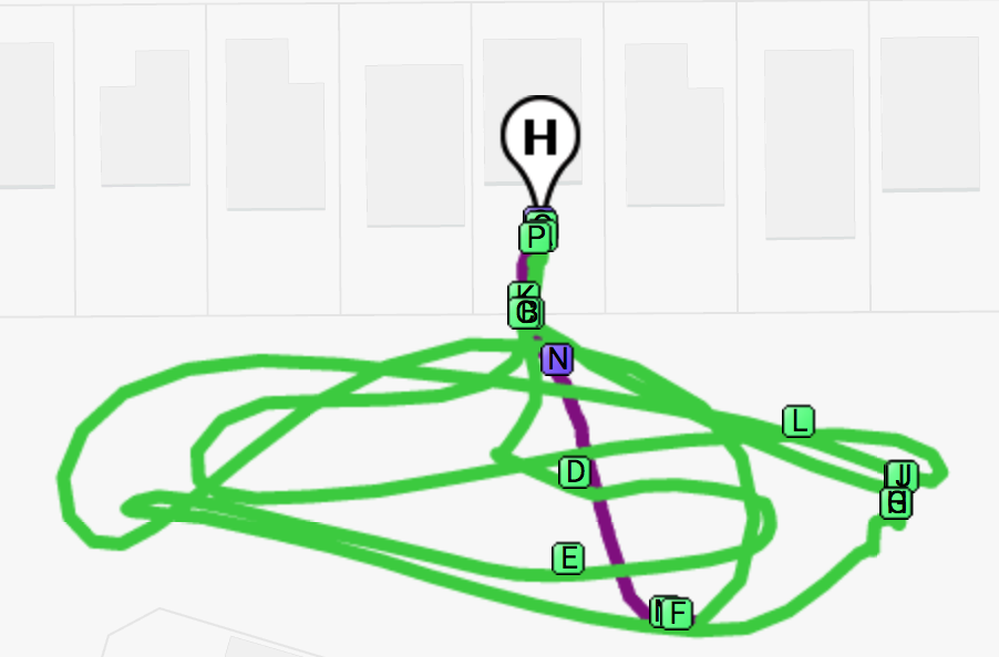

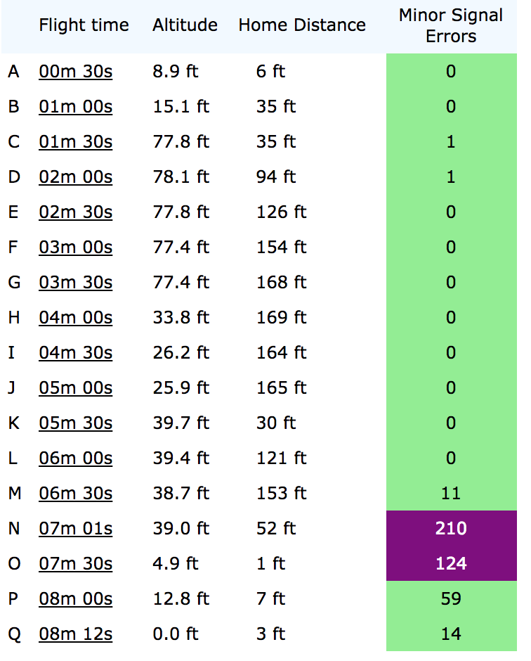

I didn't get a flight in last night but did one this morning...Everything worked great until about 7 minutes into the flight when I virtually lost all control again. This was also the case the previous times I have flown around my house.
I decided to upload my data to airdata.com to see if I could find any issues with it and it is just bizarre how the signal drops out without any warning...Antennas were pointed straight up and down and no changes where made until reception started breaking up. At that point I tried every angle possible in an attempt to regain control but the best antenna position seemed to be the one I started with. Have a look at these screenshots from airdata. First two are from this mornings flight, third and forth from a few days prior.

I'm starting to think this is a heat related problem. Yesterday I got up early enough that the max temperature of any flight was in the low 80's...Prior to that it has been around 95f when I have taken flight and this morning it was about 92. Still well within claimed operating parameters but it seems to be my best explanation of the issue. Has anyone else had heat related issues with a P4P v2.0? I'm starting to think this one is a dud.

If there was major interference wouldn't it be present throughout the flight though? It seems rather coincidental that the signal strength is good for the first half of each flight then drops dramatically. It also remains poor even once the Phantom is just a few feet away. I just flew another flight with the outside air temp at 96 and all was good until 4 minutes in and the same issue occurred. I checked another flight log from a few days ago that was flown at 102f and the signal strength drops drastically at around 2 1/2 minutes and never gets better.

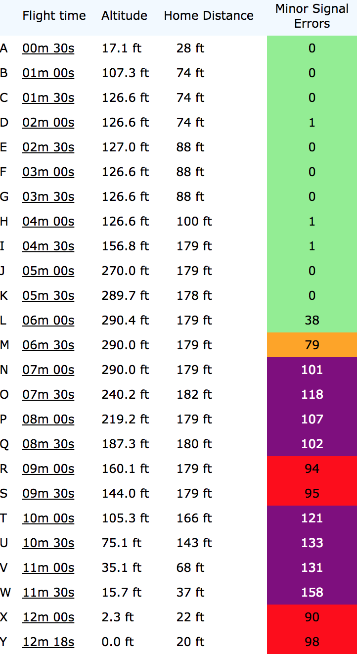

It will be going back for sure at this point. I went to two other locations, both of which I know many people fly at and had the same issue with the signal working fine until 5-7 minutes into the flight. Then the thing is completely uncontrollable and the video feed drops out.
This is the latest signal report--everything after the 5:30 mark was very twitchy and if in forward flight the drone was glitching in and out of its braking mode like the stick was being released even though the same input was being held.
Don't agree on having it repaired ,insist on a brand new one or simply ask for a full refund, it should work right out the box ...

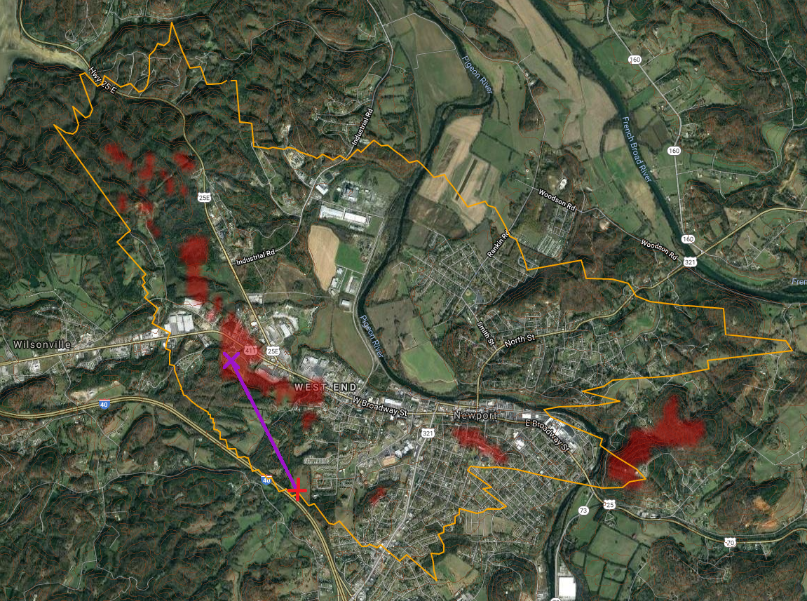

Today I sorta flew a range test with my P4P 2.0. I got about 5,290' before RTH kicked in. Drone was at 355' above me. Later I came home and used one of my geek tools to calculate where the theoretical limits should be based on where I was, where the drone was in space and what terrain was between me and the drone.
Interesting thing is that I lost signal almost exactly where the calculator said I would:
The yellow line is the theoretical limit of the signal. The magenta X is where I launched and the red X is where I lost signal and RTH kicked in. Amazing!
PS... the red clouds are ground areas visible by someone 6' tall standing where I launched.
