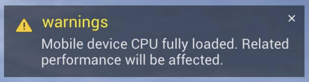

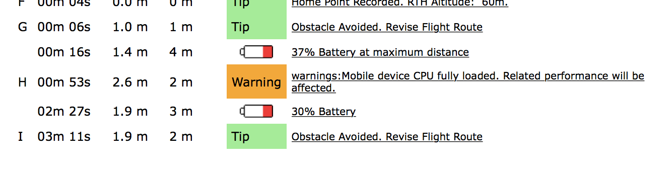

No other apps running, 18ºC.
What we would expect?
