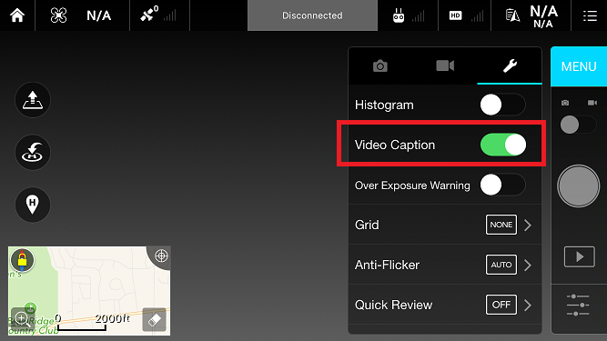

Delete the .SRT files that are stored along with your videos and turn off this setting in the DJI GO app:
Or you can just turn it off in VLC - for some reason it is on by default. It's under subtitle menu & you just disable it, or just throw the .srt file away first.
